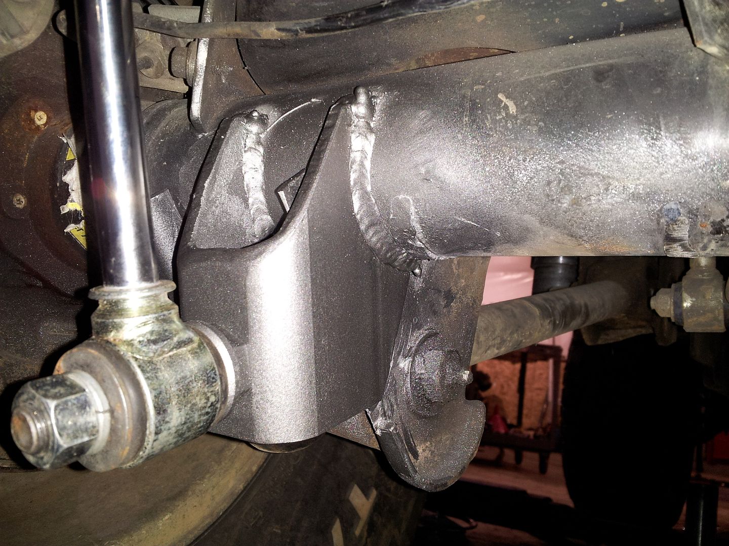

post #245 of 368 Old 01-22-2014, 09:03 PM
Leylands
Location: Palmerston
Posts: 8
I noticed the earlier style of lower relocation mounts created by mudb8 out of HSS used a bolt mounted at 90* to the axle, later posts changed this to re-using stock mounts instead which put the shock mount parallel to the rear axle. Doesn't the parallel "factory" style mount cause more wear and tear on the lower shock bushing as the axle flexes up and down?
Is one style better than the other over the long run? The earlier style of 90* bolt mount, although more work to fab up, seems to make more sense to me. No different than the upper relocation mounts rotating the shock 90*.
Leylands is offline
post #246 of 368 Old 01-22-2014, 11:47 PM Thread Starter
mudb8
want it rite or rite now?
mudb8's Avatar
Location: Estacada, oregon
Posts: 5,999
I prefer the studs. The factory mounts welded to plates work as the factory intended them to and take me less effort. I use both depending on the amount of correction i need to get or if im just relocating to clear the spring pads, exhaust and tank.
I want your factory 07-up take-off/thrown out JK front/rear Lower Control Arms! Bent ones are perfect also as long as the bushings and cold cut rings are in good shape/useable
ASE Certified Master Tech/Fabricator @ jeepwest.com
mudb8 is offline

Leylands
Posts: 8
That makes sense. This is a perfect fix for guys with limited build experience, but also those with experience who want a quick intern fix until they stretch and/or outboard later.
Any chance you can post a pattern for the HSS stud mount bracket?
Thanks!
Leylands is offline

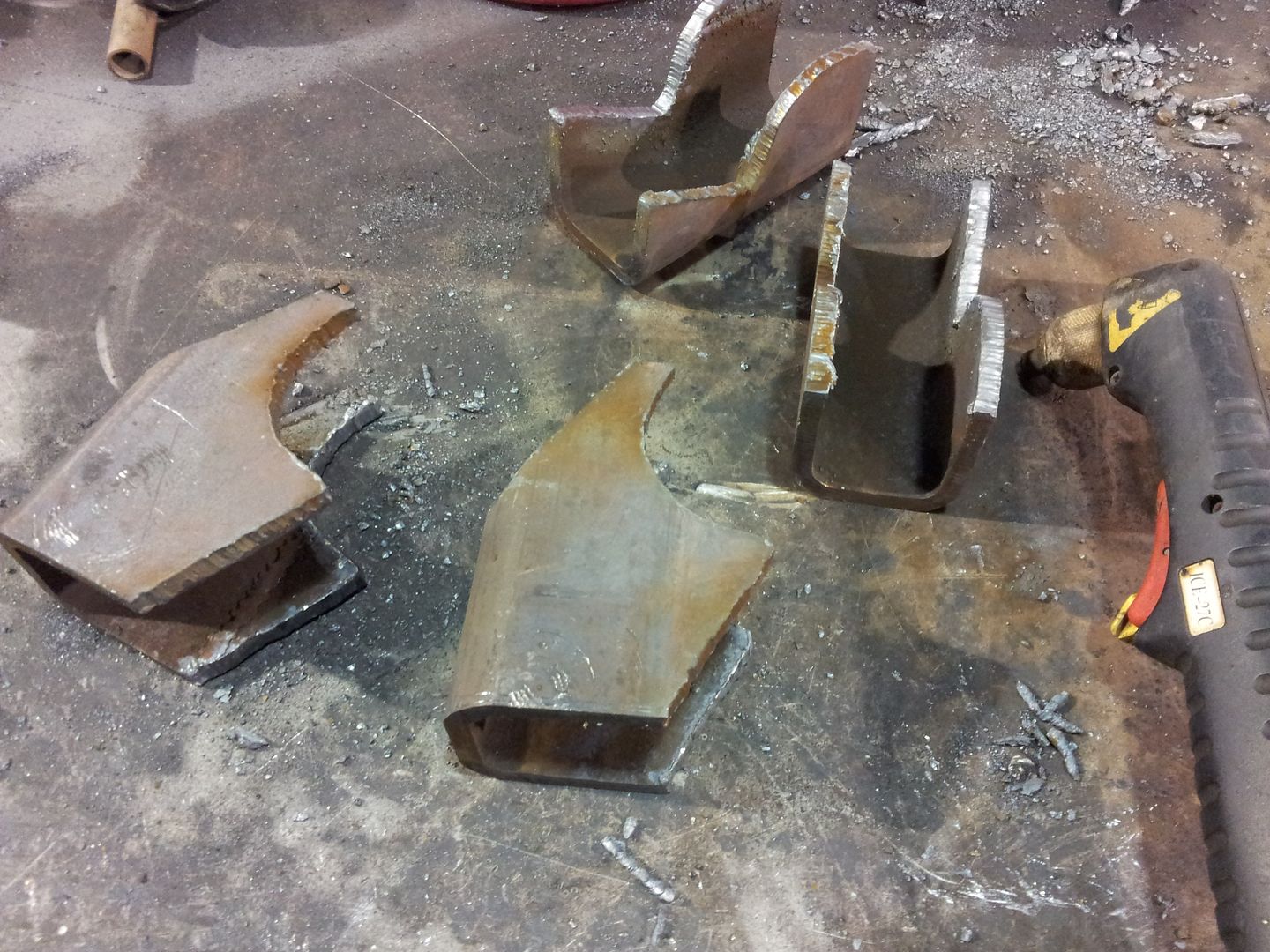

post #249 of 368 Old 01-23-2014, 01:53 PM Thread Starter
mudb8
mudb8's Avatar
Posts: 5,999
Heres a quick step by step...

Leylands
Posts: 8
Thanks for posting photos of your brackets It's hard to tell, but it looks like the upper coil mount is still in the factory forward position on your frame. Wouldn't the uptravel be improved with less coil bind by relocating the upper coil bracket level, towards the rear of the frame?
Leylands is offline
post #253 of 368 Old 01-23-2014, 06:29 PM Thread Starter
mudb8
mudb8's Avatar
Posts: 5,999
That one still lands where its supposed to, currie arms, 3" bds springs. Customer rig built one thing at a time
mudb8 is offline
