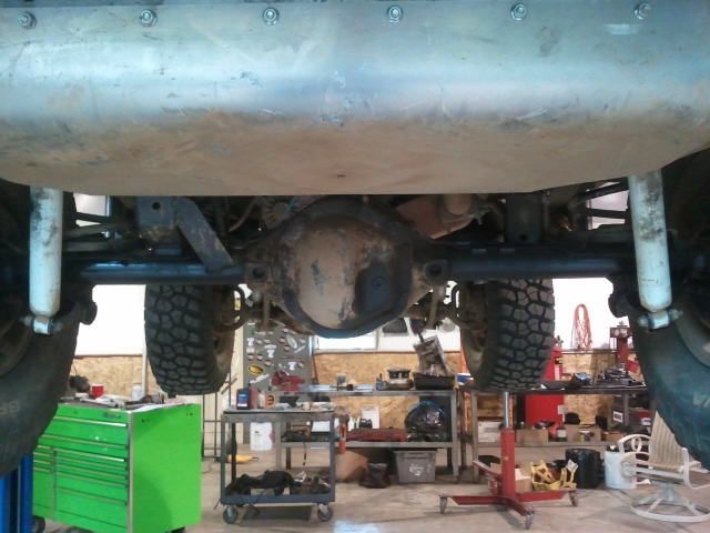

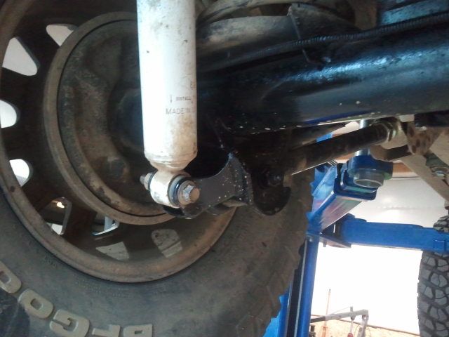

Just moving them over cleans up the axle and gets rid of a major "hang up" spot. I believe the tjs always feel mpre stable as well on the hwy with the lower mount relocated.
The standard length ome n66 is very near centered at ride height with the ome hd spring. I would simply swing it over and reattach it at the ca mount.
We all must remember not to center it up in the ca mount. The shock body will rub the frame in full suspension compression situations, not mention the upper bushing could need replacement more often.
Just did this one using the factory mount i cut off, welded to a 1/4" plate. Much like the mount you can buy from clayton off road but the clayton locates the shock a bit to far out imo. They need to be right on the inner ca bracket.
Im not sure how it wouldnt be worth the effort for this alone...

They are factory mounts welded to plate steel to span the ca mounts, i dont sell them, just something i do. It takes me about a half hour to get the mounts ready to reinstall once they are cut off the axle tube with a sawzall. I maxe up a pattern that takes the guess work out of the angle.
Just about all the tjs sold by the company i work with have some of my dumb ideas welded on bolted up or fliped over.. Rear shock mounts/damaged shock tubes and uptravel are a major peeve of mine.

I did this with mine several years ago, but I didn't weld the factory mounts to a piece of plate. Just cut them off, cleaned them up, and welded them on the backside of the lower CA bracket.
I like your idea better though. The plate would make it look cleaner and it adds some nice strength to the bracket.
