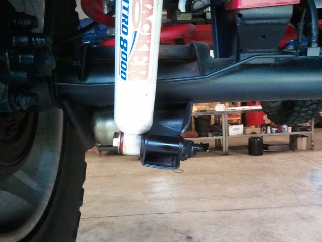

Originally Posted by UnsanePyro View Post
I'm still wishing you were making a bolt on version, any chance you would?
I have messed with a few ideas, nothing yet tho that is simple.
I had a tj come into inventory a while back with fab tech relocators that gave me a new idea. Just havent had time to explore it.
I did something i felt was a little cheesy on skyjacker's flagship LJ tho that got the right side off the exhaust and the left off the fuel tank... It did nothing for travel but works.
I cut 1/4" thick tubing for spacers which fill the space intended for the shock, added longer bolts and mounted the shocks outboard of the mounts. It has the skyjacker shock shifters intended to get the shocks off the spring buckets caused by pinion angle.
Skyjackers front trackbar relocation bracket was busted as well and had been repaired a couple times prior... I fixed it by installing a JKS take off i had laying around.
