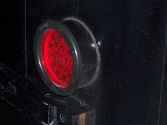

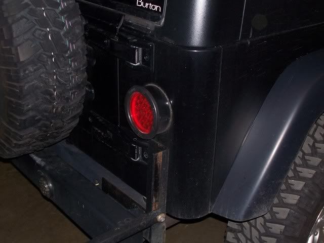

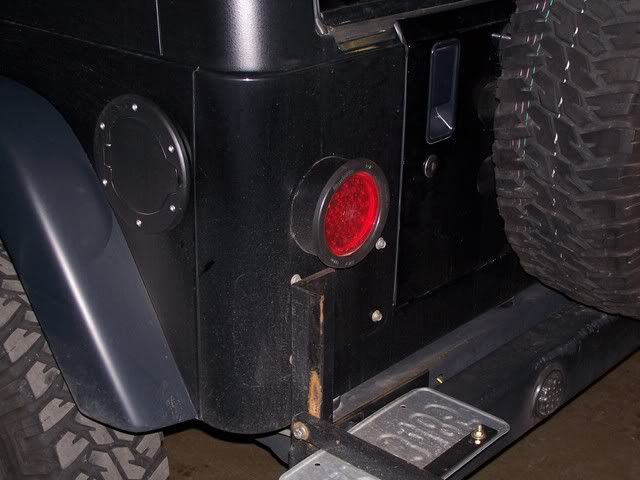

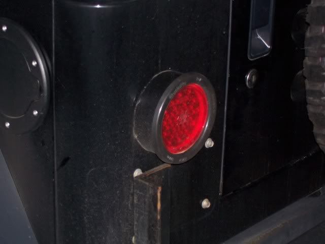

I took the roof rack down after I changed the oil tonight, so I could get some better pics. It's in a lit garage, so they didn't come out in the greatest light, even with the flash. But I uploaded 23 more pictures.
You can see all the pics here LED install pictures
I was able to get the brake lights through my work, but I had to order the smaller LED reverse lights, not many places carry that size in a clear lens. I used this site to buy the reverse lights and grommets.
http://autolumination.com/truck.htm
The brake/signal lights came in a few different types. I chose the snowflake ones, they have the most LEDs per light and are the brightest, as far as I know. I've seen them run for around 25 per light, if you go with the cheaper ones, you can get them for less then 15 per light.

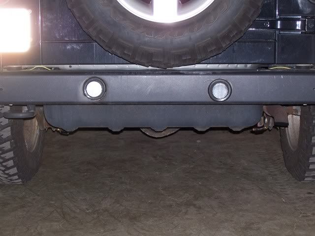

Here's a pic of the reverse lights Hazmat, but you were there when I did it. I just blew a hole using a hole saw and popped them in. I plan on doing something better when I upgrade the stock bumper.

I'd modify it to include a provision for a side marker lamp and/or a side marker reflector. Some state inspectors may fail it if they got a 'bug up you-know-where.'

only thing I'd suggest instead of silicon around the edges, pull the led lights wires through and seal around there hole, then use some rubber washers between the body and light back when you put the 3 mounting bolts back in. It will seal around the holes and the light wont be able to rub the body either. Silicone sucks if you ever have to remove one, leaves a mess on the paint

I just googled those lights. I have seen them before... I was looking for separate reverse lights. I know not having the side marker isn't legal, just not sure how I can integrate them. I may have a solution though...
