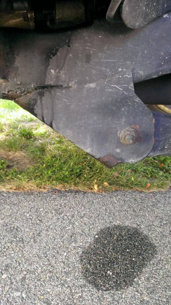

Been losing coolant pretty fast and having to fill up the reservoir a lot lately. Have noticed a spot on the front passenger lower control arm where I thought water was dripping down. But, after looking closer I noticed its green coolant.
Been doing this for a while and just gotten worse. Probably sped up the rusting too.

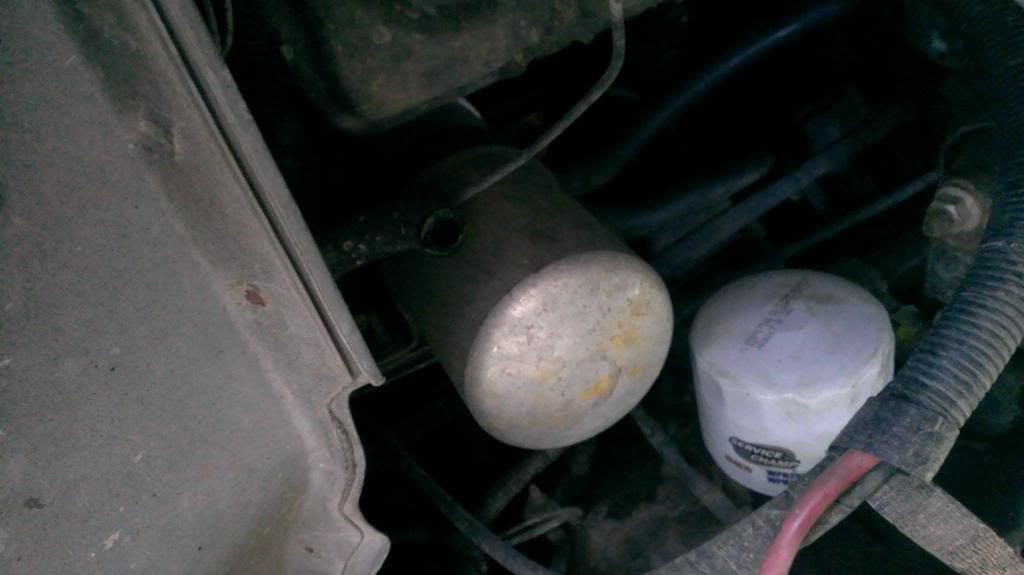

Seems to be coming from this hose above the frame. Which imo is a bad design/placement for a run off hose. Whats this coming from? water pump?heater core? something else?

looks like a heater core leak
i am actually looking into replacing mine soon.
can you smell antifreeze when you turn the heat on?

Ya I was pretty sure that was it..
When I turn the heat on yes you can smell antifreeze. Which is why i mainly haven't used the heat.
Seen that write up before.Looks pretty involved but straight forward. Thing is, a few weeks ago I installed an or-fab roll cage in my jeep and it was difficult to get in so getting out... can only imagine how hard that would be.doesn't want to budge. Which is leading me to thinking about just bypassing the heater core and going without heat. not the best option but may save me for now and can deal with it later.
