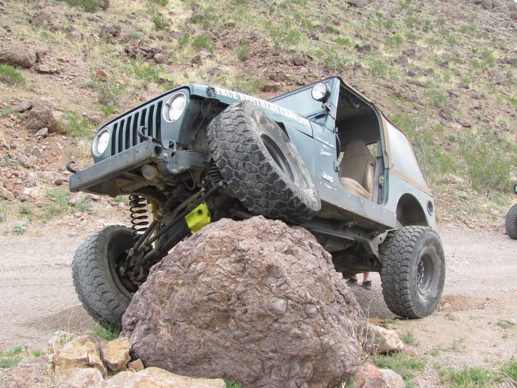

Originally Posted by 2003X
I run the 4" Rough County Long Arm, no complaints at all, flexes great, rides great on the road, and I didn't listen to the knuckleheads on here and spend $9,000 for a short arm lift kit that wont even go over a speed bump and is a foot off the ground. Do what your BUDGET allows. Enjoy.
- And you can save all the hater reply's, no one cares that you run 39s on 2" of lift and can crawl over a dump truck.
9000$, right.
And you talk about flex, and those are the pics you choose?
Stock control arms, not even fully drooped.
For the 1k you spend on an RC lift you could get currie/rokmen/savvy arm that give you stupid flex.
freeskier93 is offline

Originally Posted by freeskier93
9000$, right.
<img src="http://www.jeepforum.com/forum/attachment.php?attachmentid=274614"/>
Right, because unless you have savvy, rokmen, or currie, your jeep cant compete with any one else.

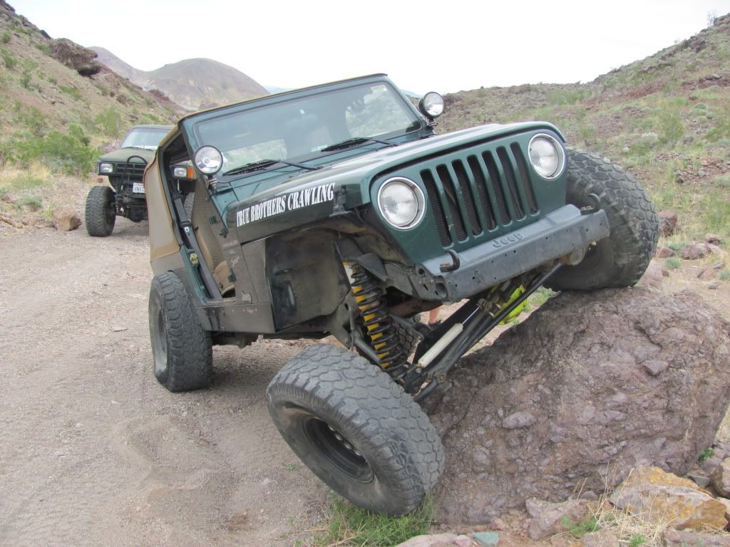

All this^^^
Coming from someone that post a flex picture trying to back up that rc long arms flex greatt and he still has the stock sway bar hooked up
Next time you talk smack on a short arm atleast TRY to give me something to compete against
4in front springs with RE arms and ome shocks, rear has 2in springs on budget boost shocks and stock control arms
And notice all tires are in contact with the ground
And I thought short arms and stock arms did not flex
SAVVY,CURRIE,GOODYEAR
Nuff said...
