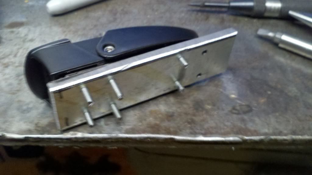

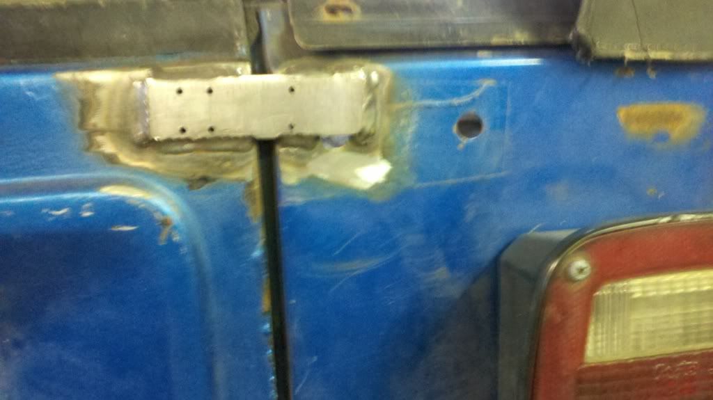

Reviving this thread because I just did this mod on my YJ
mounted them to 3/16" plate first, then welded that to the jeep
So yeah, tailgate was welded shut for a little while there

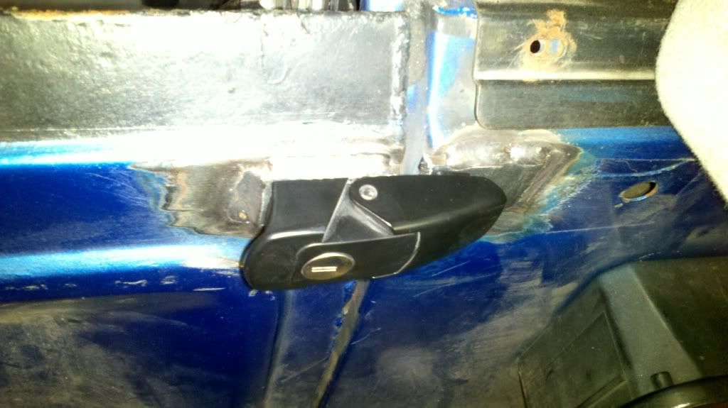

Closed & Locked:

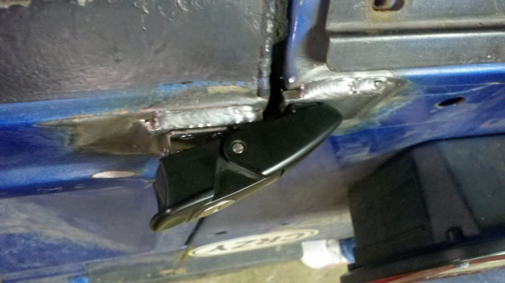

Closed & unlocked:
So yeah, I realized about halfway to getting them attached that they pull 90 degrees to the direction the door pulls... they still hold the door shut, I can hang on it and it wont open, just like you did cgmrdc but mine don't sit flat when they're unlocked; possibly too much pressure from the tailgate gasket, not sure...
but it still doesn't work like a Tacoma's tailgate... you have to buckle & unbuckle each one.
I think this is the best option I've seen so far; much better than the bungee cord I was using!!

It could be that the mounting positions are too close together. When i did mine i measured with the latch closed thn moved them apart so there would be more tension... bc yeah, the latches arent techically designed to work the way they do for the tail gate.

hmm, yeah not a bad Idea; I was thinking about maybe flipping them, and putting the lock on the tub instead of the 'gate... we'll see if I get around to it this weekend
