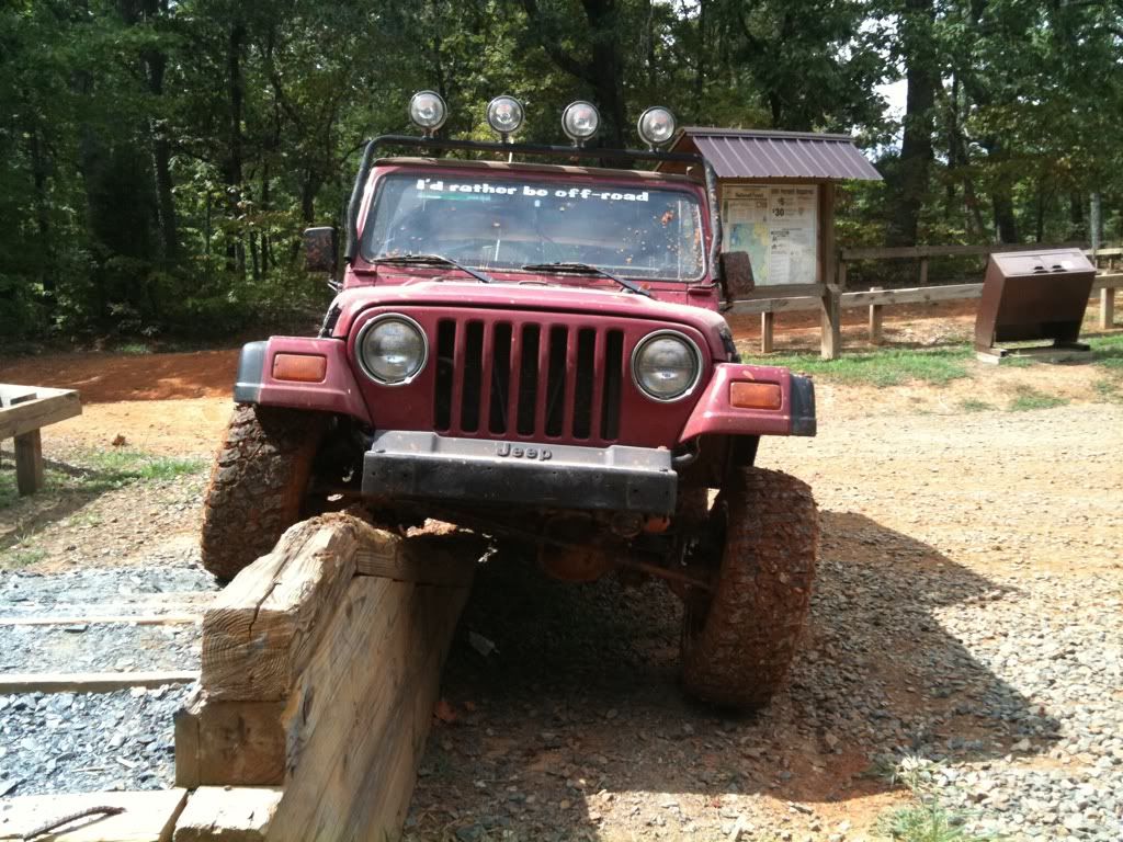

Well its time for me to build my jeep my way My goal is Low Center Of Gravity. I shall start with the history of my Jeep wrangler. Its a 1998 SE 2.5L 4 Cylinder.
I brought my jeep home April 1st 2011.
2" Body lift, 31's
Since then I removed the body lift. Herculined the interior. Touched up the Fenders. Replaced the lights (on light bar) Chopped front bumper. Installed Cobra ultra 19 CB.
The plan is 2" lift, Xenon fenders, lockers, Stinger, Winch, Driver brake light CB mount, JKS Discos, and many more!!
The day I brought my jeep home,
(gotta love the April fools hair)

Here's the bumper chop. PO must of hit a tree. Tired of my jeep looking like I'm a bad driver so here she is now;
Before
After
