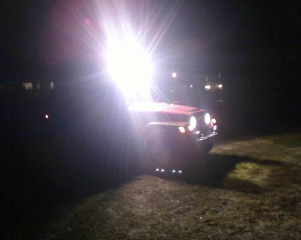

Thanks guys! I got it! This is four of the five kc daylighters on the bar. fifth one isnt on yet because i have to drill a hole in the bar to ground the light to like all the others had, not sure why the middle one didnt have it...
