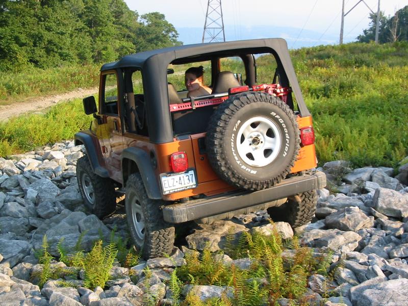

Run a 33x10.50 tire on the stock 7" rims... here's a Jeep that's setup nicely with exactly that tire and wheel combo:
http://mrpistol.tripod.com/id2.html
