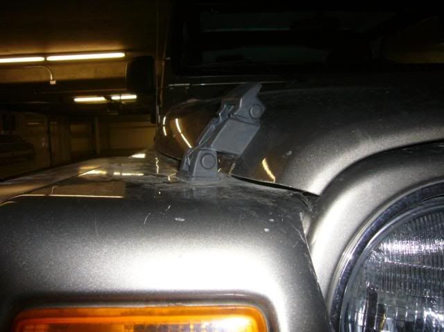

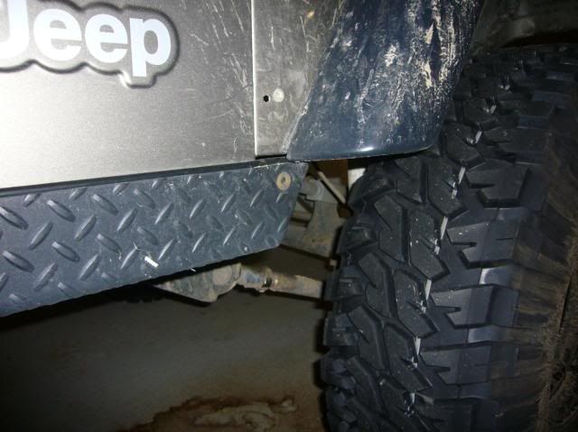

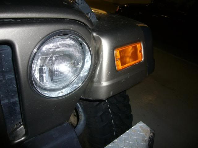

Unread 12-19-2008, 06:24 PM   #51
mudb8
want it rite or rite now?
mudb8's Avatar
Location: Estacada, oregon
Posts: 5,852
more pics, of the hack job..
the worst form....
making custom rockers to cover the raised fenders...
lower fender suport bracket...

Unread 12-19-2008, 06:27 PM   #52
mudb8
mudb8's Avatar
Posts: 5,852
rear triming and flares..
trimed bezel...
front inner fender trimin...

Unread 12-20-2008, 12:37 AM   #53
neverbackdown
Location: Port Angeles WA
Posts: 112
good job looks nice thinking about putting the blade to the jeep myself to do a little trimming
'History will be kind to me for I intend to write it."
-Sir Winston Churchill
neverbackdown is offline   Reply With Quote Quick reply to this message

did you put any sort of trim on the edge of the hood where you cut? it looks like it is rather sharp
Originally Posted by timberwolf0122 View Post
I think you are confusing the right to free speech with the right to be a **** bag, only one is protected by the constitution.
QuickSilverCon is offline   Reply With Quote Quick reply to this message
Unread 12-20-2008, 02:02 AM   #56
mudb8
mudb8's Avatar
Posts: 5,852
yeah, door trim.
i ran a flapper disc accross it so it's not sharp at all, tho had it slammed down on some fingers, they'd be gone.
