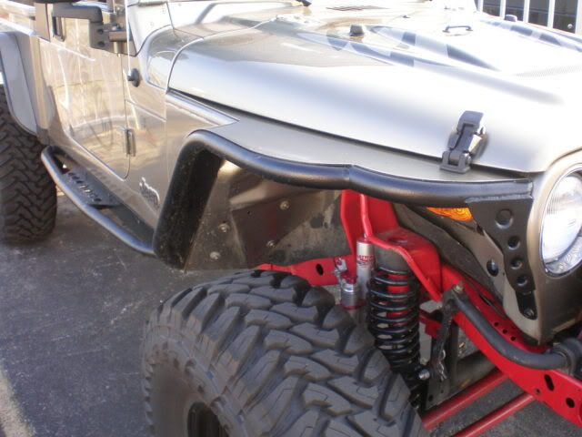

Originally Posted by geberhard View Post
very cool info! I am about to embrak on something similar, but may go into tube fenders right away, and highline the fenders. Great info!
well.... highline the tubes!

That's a sick looking highline with tube fenders there mudb. What kind of tube fenders are those?
those are DIY tubes.... lol, did ya forget how cheap I am already?
