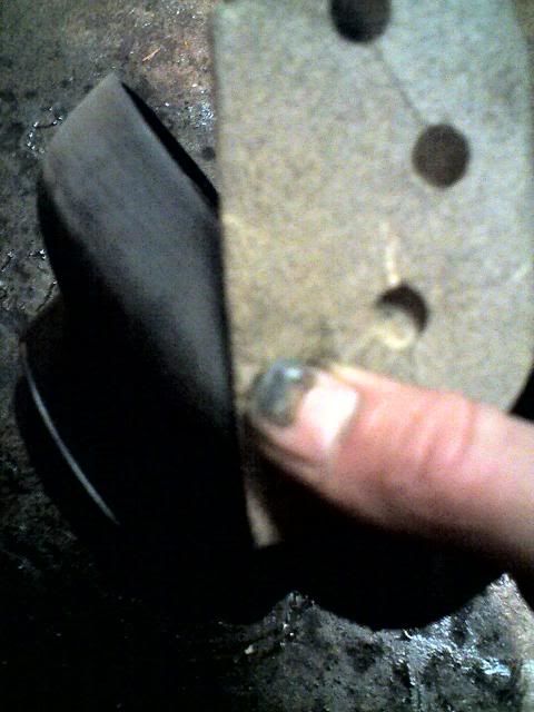

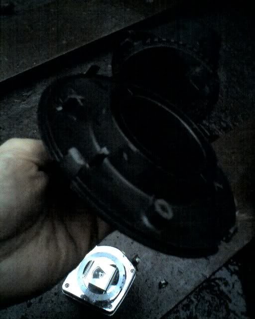

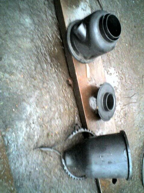

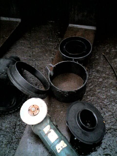

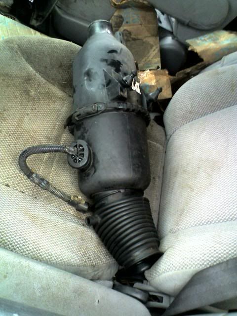

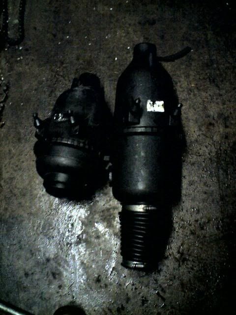

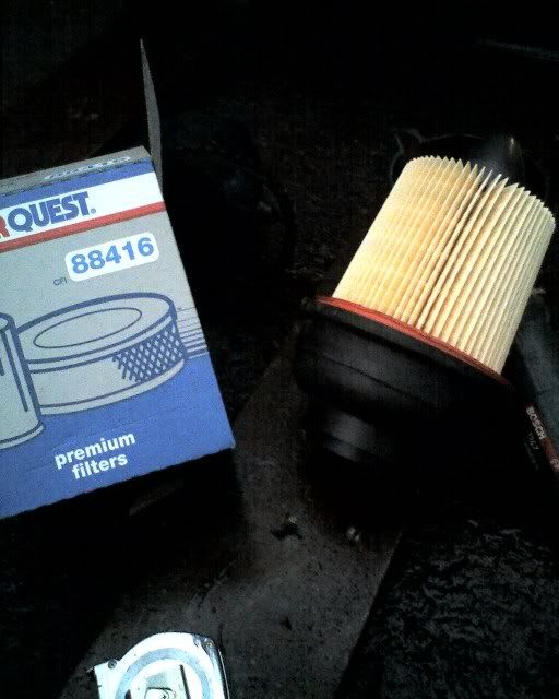

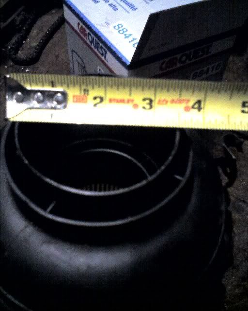

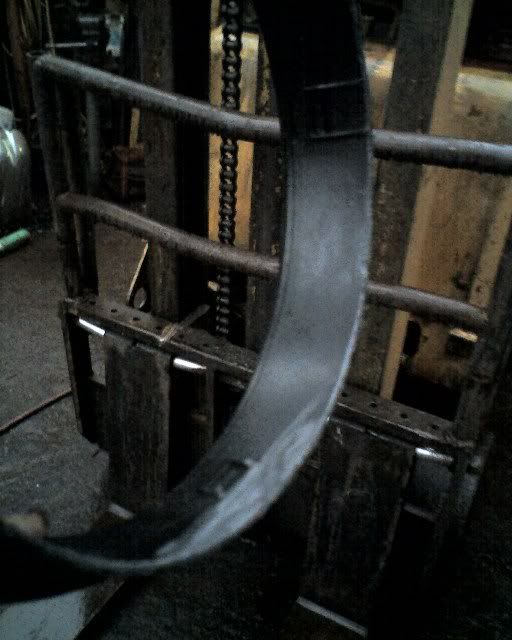

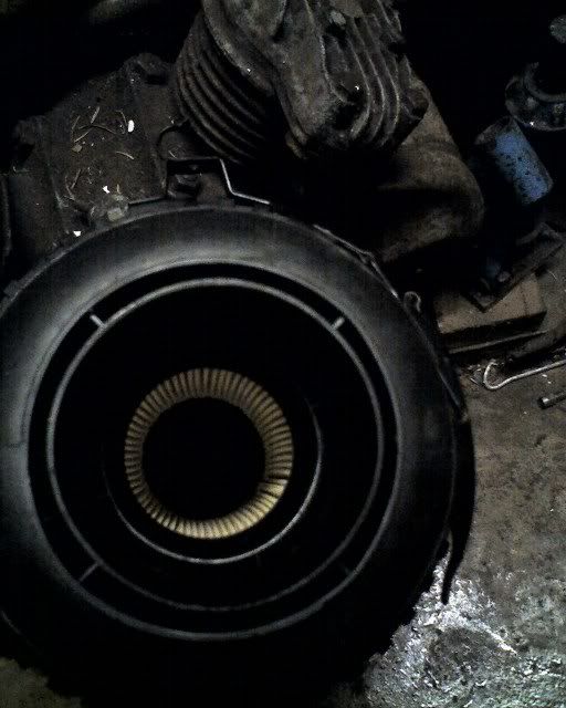

well, I found a few 97-98 ford winstar air boxes, I haven't looked at the explorer boxes yet, I've been told they are the same or similar.
I've got em shortened and ready to be installed.
I still haven't gotten around to making it a "cold air" from the cowl yet, tho I can say it got rid of the stinkin noise from the hacked off factory box and cone type filters...
u-pull-it special..
hacking it up...
fine tuning....
putting it back together..

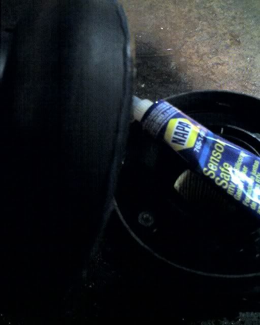

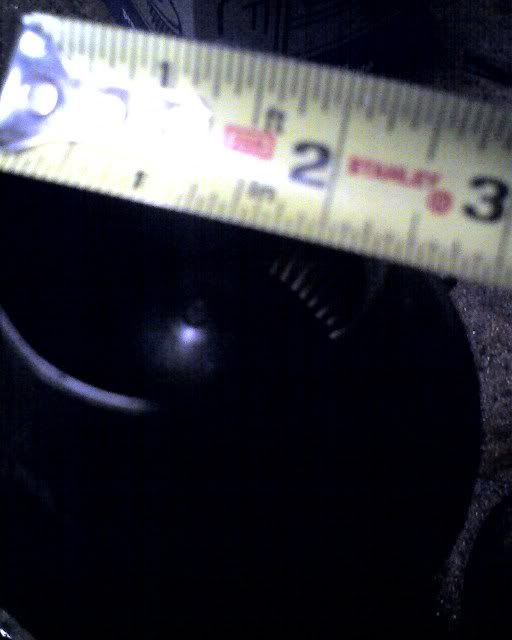

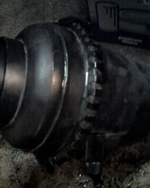

finished..
intake side..
box to tb...
installed pics later when I get around to it!

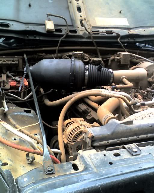

here's the getting around to a pic of th air box temporary install. it'll be in the cowl when it's done...

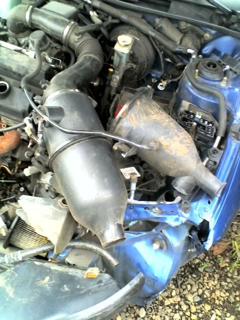

another option i ran across... this is a 99 escort air box. same filter just a different air horn... in the pic I put the air horn off of a 98 winstar on the 99 escort to check the fitment still installed in the escort.. I've found in u-pull- it yards, hardly any of the rigs have a complete box so ya gotta search for parts to put together a complete unit..
