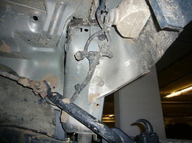

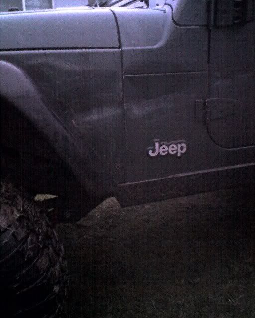

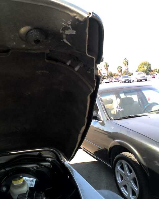

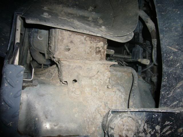

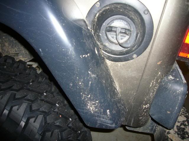

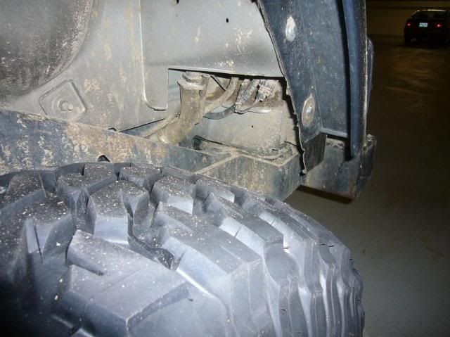

more pics, of the hack job..
the worst form....
making custom rockers to cover the raised fenders...
lower fender suport bracket...

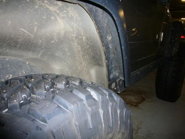

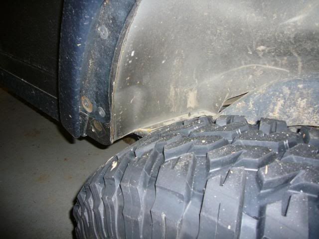

rear triming and flares..
trimed bezel...
front inner fender trimin...

did you put any sort of trim on the edge of the hood where you cut? it looks like it is rather sharp
Originally Posted by timberwolf0122 View Post
I think you are confusing the right to free speech with the right to be a **** bag, only one is protected by the constitution.
QuickSilverCon is offline
post #56 of 339 Old 12-20-2008, 01:02 AM Thread Starter
mudb8
want it rite or rite now?
mudb8's Avatar
Location: Estacada, oregon
Posts: 5,999
yeah, door trim.
i ran a flapper disc accross it so it's not sharp at all, tho had it slammed down on some fingers, they'd be gone.
