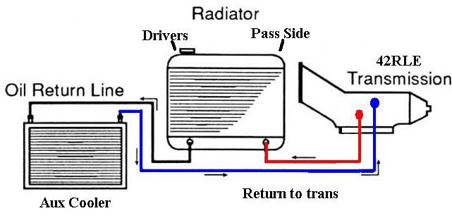

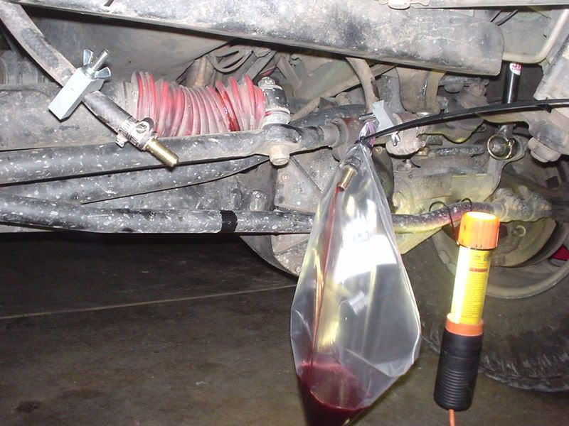

FYI - for those plumbing up a 42RLE tranny cooler...
The hot side is the lower line on the drivers side of the tranny - it's connected to the passenger side of the radiator.
The cold side (return to tranny) is on the upper drivers side of the tranny - it's connected to the drivers side of the radiator.
This was pointed out to me by another member on here (with an 06), and I verified it on my 04.
This shows the tranny fluid which normally would be routed to the passenger side of the radiator - this is the hot output of the transmission.
So...my junk is actually plumbed wrong, and I've been advising people wrong for a few years . dang it. and jerry, if i'm reading your write up correctly...you plumbed yours the same way I did, and we're both cooling the fluid before it enters the radiator, since the passenger side is not the return line, it is the inlet line.
The correct cooler plumbing should look like this:
so...might want to check how you plumbed your 42RLE cooler.
Wow, so Jeep DID switch the sides for the OE cooler on which is in and out. I'll have to correct that on mine and let Derale know.
So this change looks to be effective from 2003 and newer when the 42RLE was introduced. I'll update the above writeup by this weekend.

I don't think it really matters which side you disconnect from the radiator. You either get it before the cooler in the radiator or after the cooler. One way or another it's before the fluid goes back to the transmission, which is what you want.
JBTJ is offline
post #95 of 553 Old 09-15-2011, 07:08 AM
Heath
2014 JK Wrangler
Location: Shreveport
Posts: 2,642
Negative Ghostrider. You want the coolant to cool it first, then the exterior ambient air. It gets the coolest that way.
2013 JKU Rubicon
Heath is offline
post #96 of 553 Old 09-15-2011, 07:14 AM
UnlimitedMatt
Location: Westminster
Posts: 388
I disagree. There is a possibility of the radiator heating your pre-cooled fuild if you go to the auxiliary cooler first.
The direction is important especially if you decide to add an auxiliary filter.

Your right, I was thinking it didn't matter which line was disconnected to do a drain of the system, DUH! Reading too many threads at different sites at once. But yes it's better to have the aux cooler installed before the factory cooler. Thanks for setting it up straight for me.
JBTJ is offline
post #98 of 553 Old 09-15-2011, 07:23 AM
JBTJ
Join Date: Mar 2006
Location: Dallas
Posts: 11,591
Unless you live where it's really cold and you need the ATF to stay warm. Cold ATF is just as bad as too hot ATF.
JBTJ is offline
post #99 of 553 Old 09-15-2011, 07:52 AM
Unlimited04
This post/info=my opinion
Unlimited04's Avatar
Join Date: Dec 2005
Location: Colorado
Posts: 24,211
ok, you're both right.
I've been thinking about this...and i've had mine plumbed backwards, and my tranny temp gauge has been measuring the cold line back to the tranny. So what I've actually been seeing....if we assume the cold line is a good approximation to the average pan temperature (temp measurement method advocated by Blaine and Robert).
I have seen trans temps running almost too cold, when the ambient temps are quite cold. So there is a benefit to cooling the tranny fluid before it enters the radiator - so it can absorb heat from the coolant in the winter, when thats a good thing on warm up. On the highway that cold line has normally 160 or less after long travel distance & plenty of time for heat soak.
However, I've also seen very clear indication the trans temps increase with increased coolant temps. Wheeling, I've seen around 200 temps going back to the tranny when the radiator was heat soaked at 235. So we can probably assume the trans temp without the pre-radiator cooler would be over 200.
This brings me to my idea of a dual cooler system -
Here, the fluid is cooled before entering the radiator by a front mounted aux cooler. This would prevent tranny fluid from adding heat to the coolant, when the tranny fluid is very hot, say when towing. But it's also going to prevent the fluid from becoming too cold in the winter, since the coolant will transfer heat to the tranny fluid when the tranny fluid is cold.
Now, the aux cooler mounted under the tub, with a 180 switch (or temp/toggle switch of your choice) would only become active when the fluid going back to the tranny is 180 or above. So in the winter, this is likely inactive, but in the summer when towing a camper, or when generating a lot of heat (like the radiator is overheating), the fan kicks on and the secondary cooler becomes active.
Another option is to plumb the two coolers in direct series such that the fan only kicks in when the 1st cooler doesn't provide enough temperature drop.
Maybe those two systems are complete overkill....but consider my tranny has blown once I'll error on the side of overkill. Opinions?
There you go. My brother has a construction business building roads and bridges and such. He got a contract in Alaska and he had re route the cooling lines on his trucks in this manner.

Excellent write up Jerry, but I have a question. I know you spliced in the radiator for the inlet/outlet connections. One of the problems I see with the TJ and the 42RLE are the lines running directly past the two mini cats. Would it be possible to just run new shorter lines directly off the transmission to the new cooler and back?
05 Electric Lime Green LJ with a 4spd Auto, 2.5inch Suspension Lift, OME Shocks, OME Steering Stabilizer, 32inch BFG M/T's on 17inch Moab's using Spidertrax Spacers, UCF Aluminum TC Skid, Novak Cable Shifter, Brown Dog MML, Rokmen 1/2 BL, Banks CAI, Diehard Platinum Marine Battery, JW Speaker 8700 LED Head Lights, Safari Nets, G.E.A.R Overhead Console/G.E.A.R Tailgate Storage, Rugged Ridge XHD Front Bumper, Warn Gas Tank Skid, Mopar Rock Crawler Rear Bumper, Warn XD9000i Winch with Warn Wireless Remote, and a Uniden 880 CB Radio

I'll be back underneath my TJ this weekend to swap where the hoses connect to the radiator and I'll take a look at that area while I'm there. I don't recall being concerned about any hose's proximity to either of the two mini-cats.
