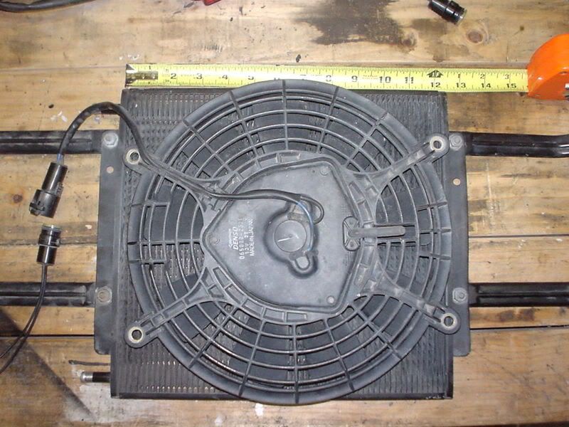

For those looking for a cheaper junkyard alternative to this Derale...
Biggest tranny cooler I could find in the junkyard off a truck (12" x 12" or so) and a Denso pusher electric fan off a late 1990s Land Rover. The fan is only two wires - power and ground, and the mounting thickness is 2". Fab up some brackets to make it all fit and hook the fan to a relay & thermal switch or toggle switch, and you've got a low cost option. This Land Rover fan runs $330 ea in the aftermarket and ~$32 for two at the junkyard.
