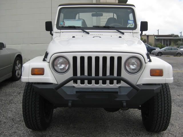

I installed my front bumper last night. It was slightly out of alignment, or my jeep was, so I had to file the bolt holes out about 1/8". Only took 10 minutes and the bumper looks great on the jeep.

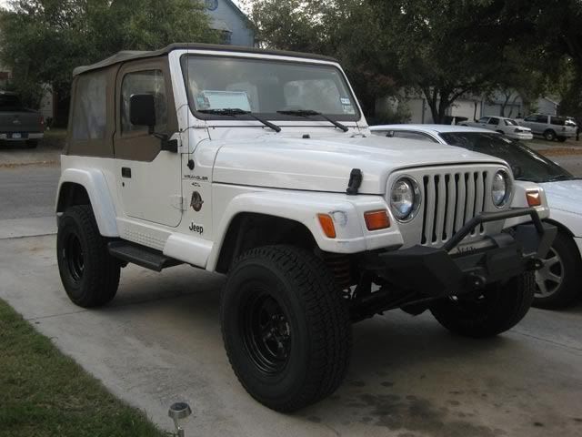

Here is the choice I ended up installing on my TJ. Double Powder Coated, Top plate 3/16"...bumper 2"x4"x3/16" tube.....lower mounting brackets 3/16" plate. The bumper has a 2 each clevis mounts, a 2"x2" receiver (not visible due to my custom made license plate bracket), however it is more of an accessory receiver. I plan to mount a heavy duty receiver on the top plate also. Plans also call for mounting my tow bar brackets direct to the front of this bumper.
Savings were about $100 over the Tuff Stuff bumper delivered.
