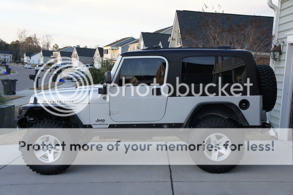

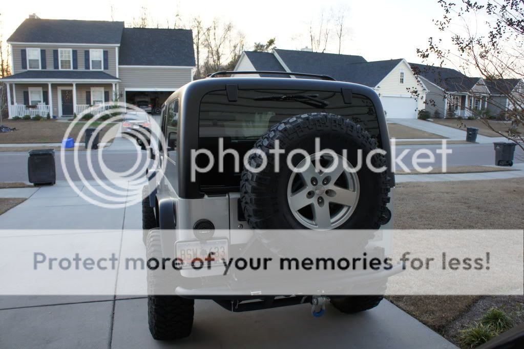

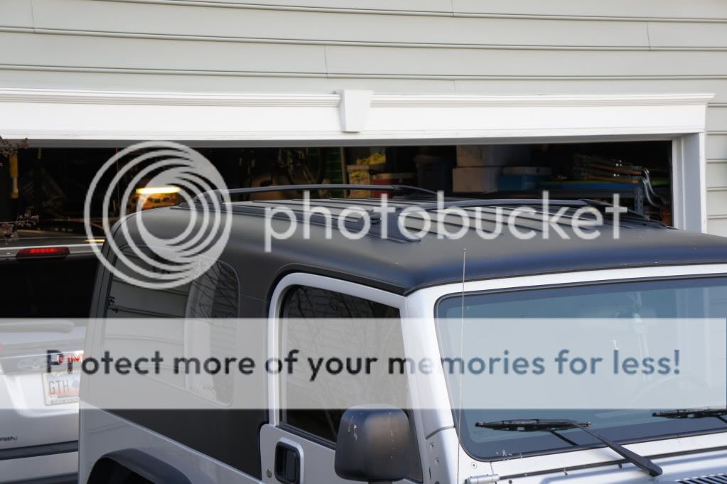

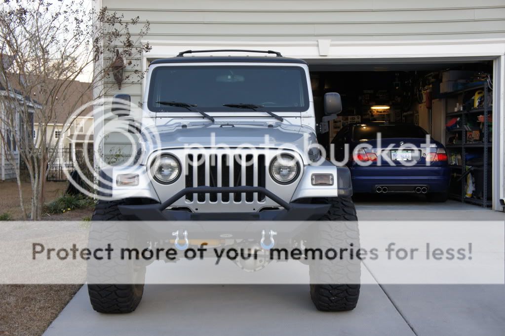

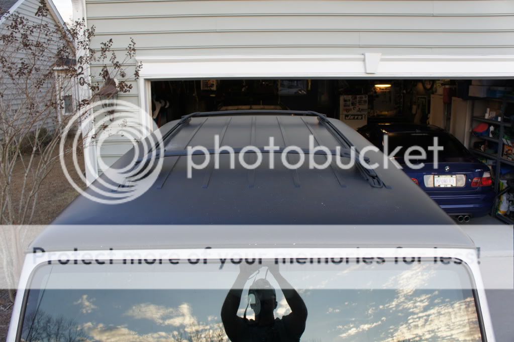

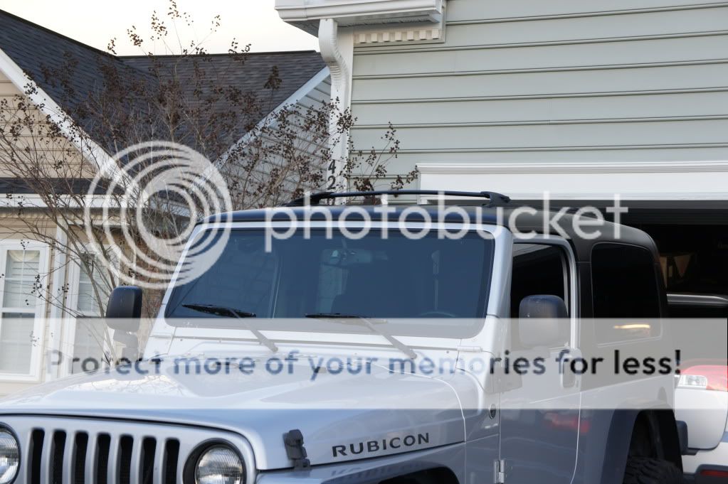

I used a rack off a 1999 Ford Windstar. I think its pretty much the same rack as the explorer, but looks like it might sit lower. Only mod i had to do was to cut 1/2 inch off each cross bar and the rack fit right on b/w the outside ribs. After locating some hardware from Lowes and a can of black spray paint, the rack looked good as new!
I can fit my snowboard racks on there or a roof bag so it works for my purposes. Wanted something that didnt really stand out and looked stock. The nice part is that the crossbars slide out, so when they are removed you really cant tell that anything is up there
Here are some pics:
The Before, worn out...
All finished up:
