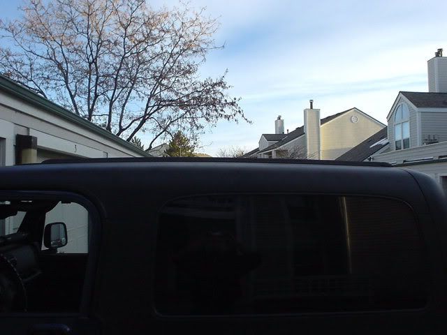

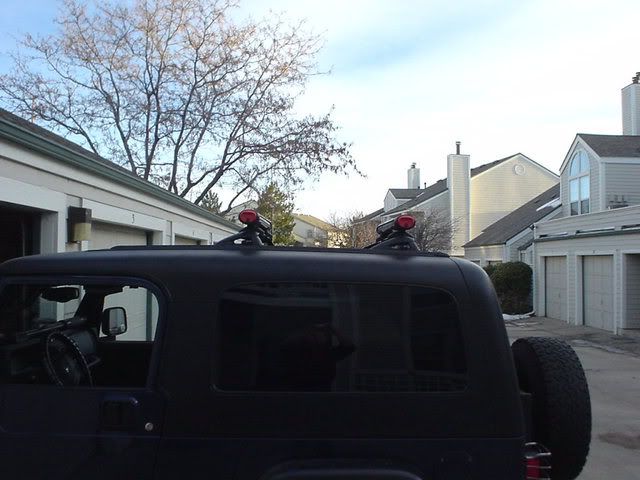

finally got my Ford Exploder roof rack on
-used stainless button head bolts (0.75" long)
-made aluminum spreader plates 1" x 1.5"
-used black weather & sun proof caulk to seal the holes
Nice it is so handy you'll love it.

Can you post pictures of your rack? Especially inside and out where you mounted it? I've got mine almost ready to go on, but it looks like there is potential for interference with the one or both of the main support x-members of the LJ hard top. Where did you drill? Where did you position the rails in relation to the rear molding lip? If you didn't drill through one of the x-members, what is the distance from the the rear molding lip in the hard top to the rear most portion of the rack rails?
better late then never?
Front
Rear
With 5 screws on each side I didn't think I needed anything bigger than the large flat washers. But now that I am thinking of using the roof rack to lift up the hard top by via a overhead winch set up, I think I'll replace the washers with something bigger.

^^ thats exactly how i did it. but if you're going to be hoisting the hard top up by just the rack then definitely add some kind of backing plate, and maybe a couple more screws.
