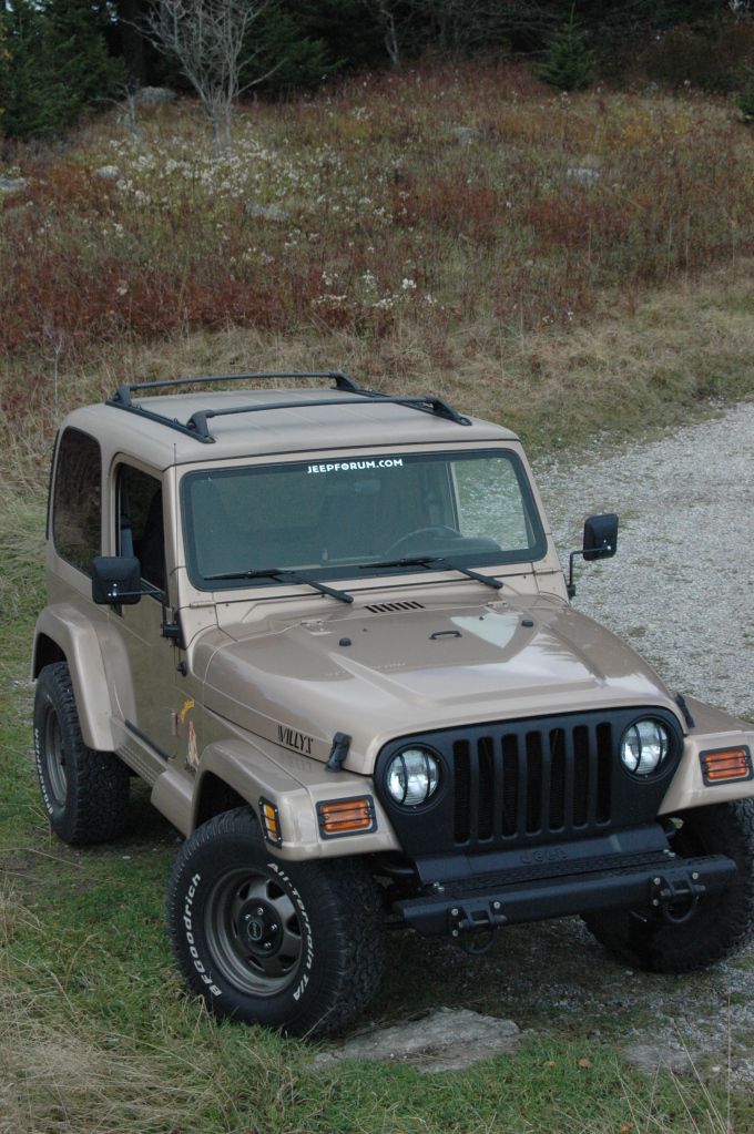

Explorer rack, $20 at the jy. I unbolted it myself. they use a large phillips screw into a threaded rivnut in the roof of the Exploder. The hardest part was finding one that would unscrew. If I remember, I only cut about 4-6 inches off each track using a cutoff wheel. The TJ roof is curved a bit, but the tracks flex enough to bolt them right down. I used ss hardware with fender washers underneath. I also used rubber washers on the inside to seal it. No leaks at all. I have had it for over a year now and have hauled anything from 2x4s to a 16ft kayak with no issues.

post #180 of 216 Old 12-21-2013, 11:51 AM
Submariner
Submariner's Avatar
Location: Montesano
Posts: 577
Originally Posted by JC_LJ View Post
That's what I thought. But I was running low on time and the roof was covered in snow. I have an LJ, so I don't think I'll need to do any trimming. I'm mounting a conferr cargo rack to it.
go down to harbor freight and get two atv racks and bolt or weld them together.
Works fine and about $350 cheaper. I would add a 6 to 8" piece in the middle just to make it a wee bit longer.
