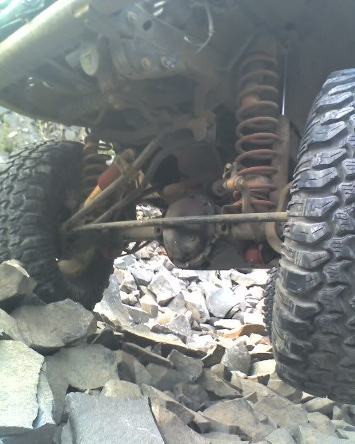

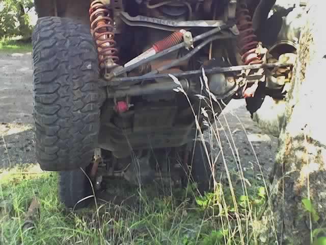

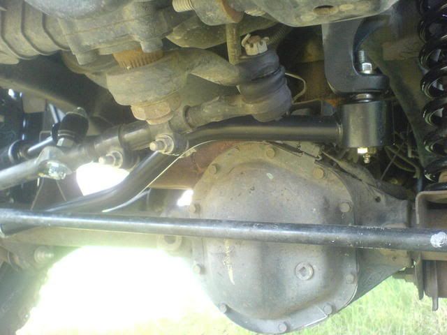

I have a few...
tj app...
wj grand cherokee app.. this is on my rubi with a nth degree frame brace, it has tons of clearance with my 2.5" lift, the bend is away from the diff instead of over it... the wj bar will work in the RE and clayton type front relocation brackets also. it'll work with the procomp bracket also.

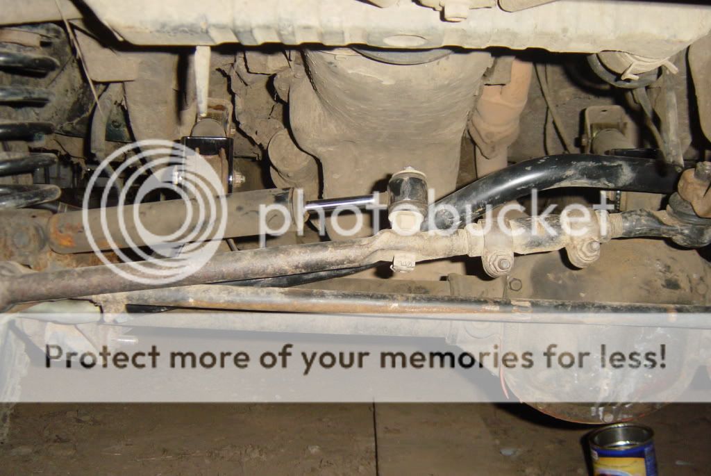

I have a 4" lift and my JKS doesn't hit at all on the diff. I had a solid cover on there for a while and that didn't hit at all with that either here it is as she site now. Bad pic but it still shows it

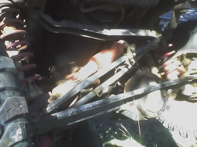

here's a couple pics of stock bumpstops getting pushed out of the bell sockets.. they get hung up on the coils as you can see. longer ones are worse yet.
