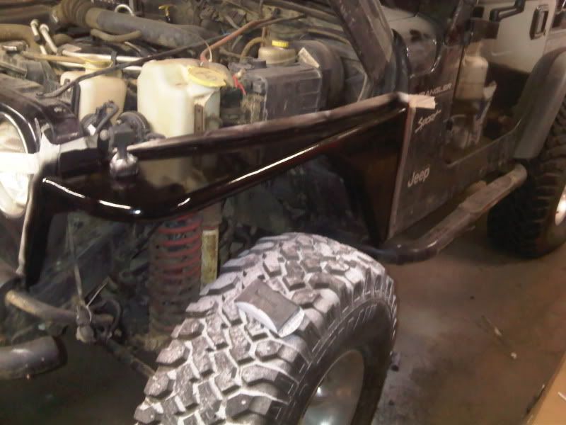

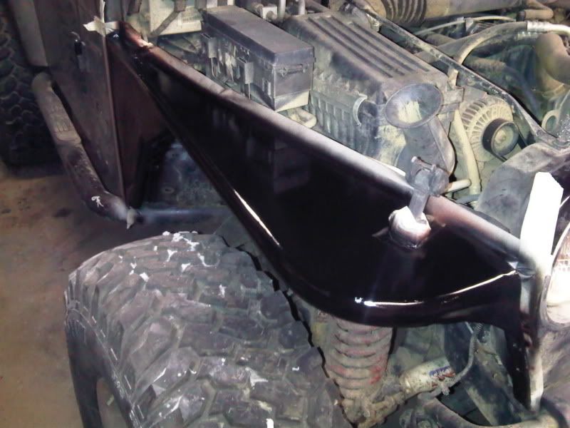

Finally found some time this week to work on my fenders. I ended up cutting off all the sheet metal that I quickly tacked in place. I had to make some new cuts but had everything fitting quite nice. I welded the panels back in place. (Sorry I didn't take pics of that) I also created a new corner section, I may be able to mount some parking lights to it in the future.
For a smoother look, I applied fiberglass (gorilla hair) body filler to the edges. I sanded it smooth and sprayed some primer on them. Here is what I have so far...
(I unbolted the front of the fenders for painting)
Nice job smoothing everything out. What's your total investment so far in this project?
Thanks
The tubes were $100 shipped and the filler I had laying around from another project. Luckily my bro in law gave me the sheet metal for the tops and sides
Thanks to the freebies, I only have $100 in it.
I think the toughest part of this project was trimming underneath the battery tray and securing the tubes to the existing inner fender.

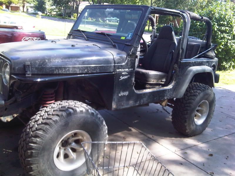

Here they are painted and bolted back on.

I installed some lights to make my jeep semi-legal again I found some 3/4 inch LED marker lights at a trucking supply store for $13 each. I put masking tape on the corners and measured and marked where I wanted the lights.
(I apologize for having the worlds messiest garage (there is NO room with 2 cars in a tuck under, in fact I can't even open my hood all the way)
I then drilled the holes for the lights, I used a 3/4 inch hole saw.
And popped the lights in.
Now that I had some turn signals, it was on to the parking lights. I found some LED lights at HF for about 6$ each. I again measured and cut the holes and installed the lights.
I think I still need another set of lights, so I have more of an illuminated presence from the side..
I will post some better pictures once I get the Jeep out of my 1 and a half car garage.

Originally Posted by 06camarodude View Post
Looks good! I probably would have just mounted some turn signals behind the slots in the grille, in case I were to ever put a set of stock fenders back on, but I like the way you did it. Looks very CJ-esque. lol
Great work! About how long would you say it took you to make the fenders?
I bet I had 10 hours into them before I decided to smooth the edges out.
The bends in the tubes were perfect, I did have to shorten the length on the top tubes a bit. Cutting the bottom tube to meet to the upper was kind of tricky. Someone on here suggested to practice "notching the tube" and I can see why. It was a fun project and it was functional.. more clearance for 35's
