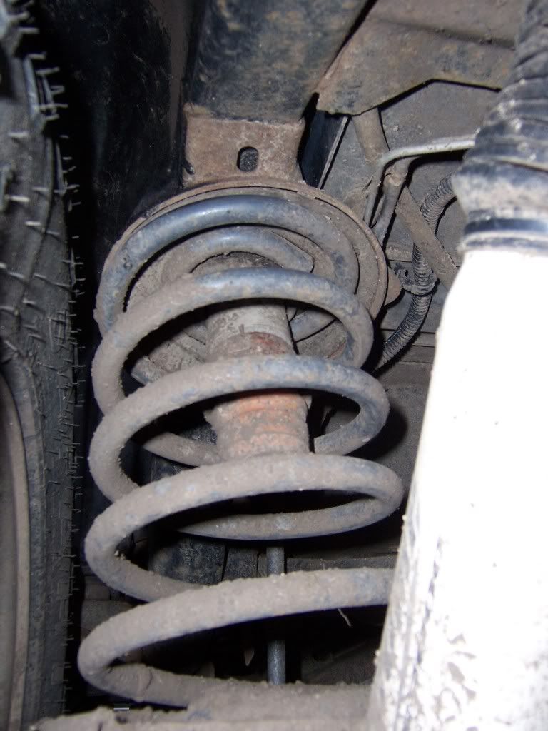

just took pics, it doesn't look like i have spacers but im not used to lifting suspension
back
front
MudPlease is offline
post #13 of 21 Old 09-10-2009, 08:32 PM
442Wrangler
In like Flynn.
442Wrangler's Avatar
Location: Little Lamplight
Posts: 2,278
nope no spacers...but the front springs def dont appear to be stock...

I think this tj has a 4" procomp suspension lift on it, but the cheaper version
