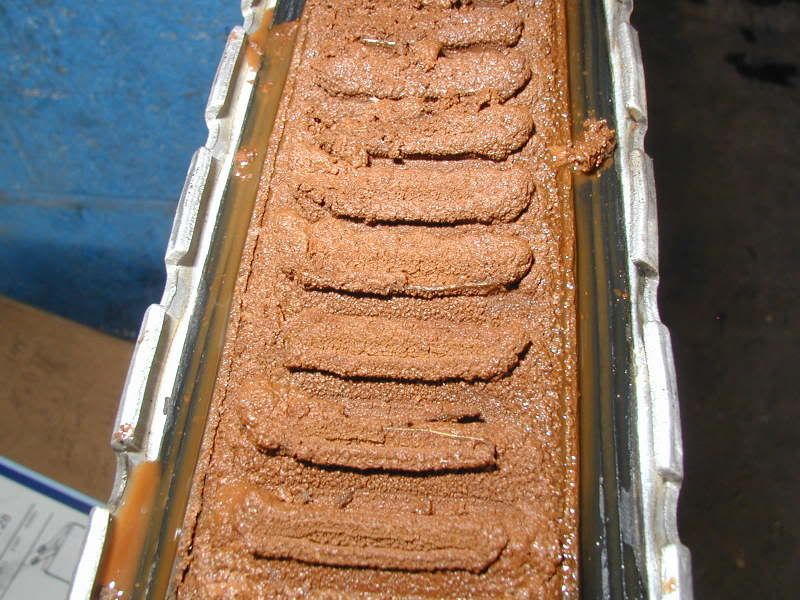

It is a very, very bad idea to mix OAT type (Dex-Cool or any Prestone "Universal" product) with HOAT type coolant. Sludge will form,and it will be near impossible to get it all out of your engine and radiator!
This is what DexCool does...
