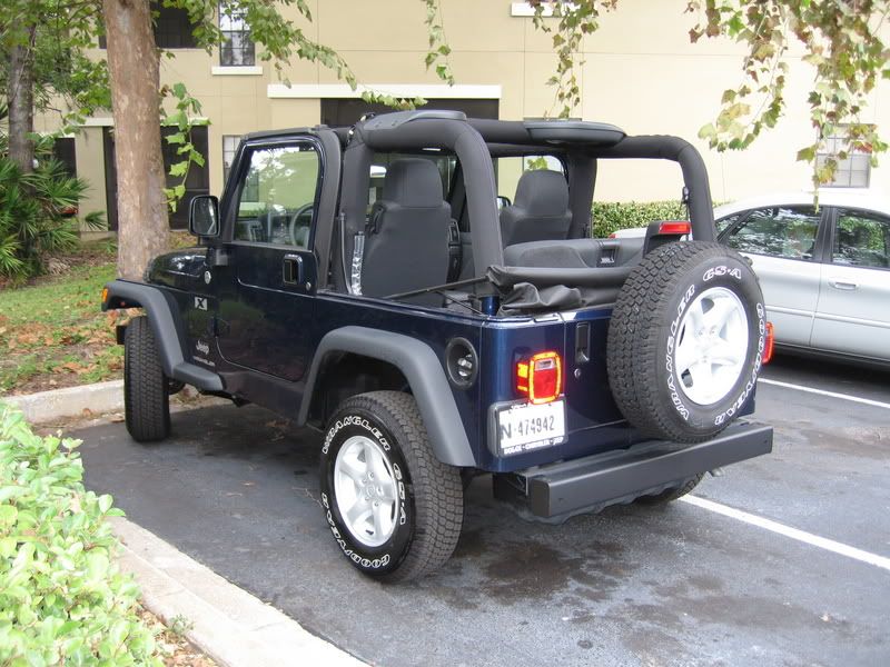

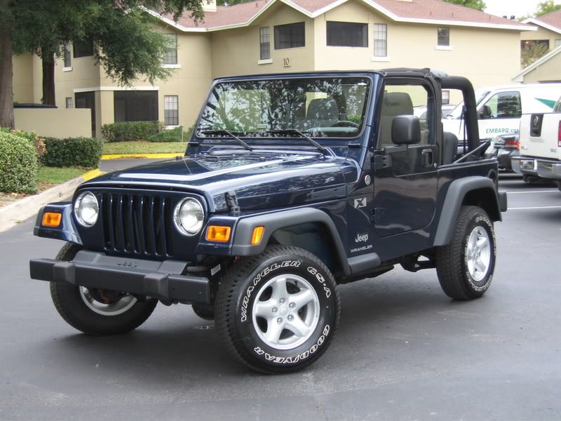

Hey all, I finally am a Jeep owner. I went to a dealership today with the intent of getting a Jeep green X with only air conditioning and speed control as its options. I ended up getting a midnight blue X because it had the red dot discount of $1000. After a little bit of haggling (with a very friendly salesman that just started working at the dealership) I was able to get $1500 below invoice total, along with 0% financing. Anyway, I am absolutely thrilled right now, but I did realize that the Jeep I bought doesnt have speed control. I've never had a car without cruise, so I'm not sure what to think about it. I will just try to suck it up and get used to it, but I also wanted to find out if there were aftermarket options for cruise control. Anyone familiar with this?
Oh, and here are the obligatory pics:
EDIT: the IMG commands do not appear to be working. This is the first time I have tried posting to this site. Any tips to make the pictures show up automatically?

Nice Jeep! Looks like mine but newer.
Inspires me to go out and clean mine....but it's cold out so......
I'm over it.

Nice ride looks like mine!
