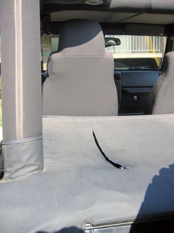

Believe me... I've had my share of run-ins with the thieves!
This summer they did this, even though the top was down and there were NO DOORS! And on top of that, I'm considering moving to the #1 auto theft state next year.
