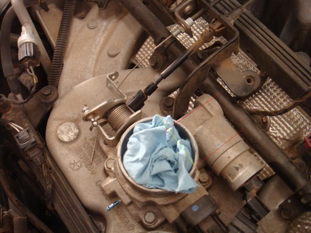

OK, here are a couple of pics. You can see that I've disconnected the elctrical connections for the IAC & TPS. The IAC module is complete cylindrical, no screws - not even the ears for the screws as shown on the diagram I posted.

Yea thats must have been a change in 05 , how bout bolts that hold it to the throttle body Can't see if it has any at that angle and if it did it would be a pita to get off with out having the TB off.
looks liek it may turn off But that could just break it

No screws or bolts on it. But I'm afraid of breaking it. If it's threaded in, I don't know which way it turns, or how tight it is. I don't know how strong the bolt ears hold the throttle body down are, being that they're cast. And I don't want to take the throttle body off if I don't have too because of the gasket. The stealerships around here never have jack, so I'd have to wait for it.

Where the red lines are there bolts holding it to the yellow line in is it 1 big assy ?

No sir. The throttle body is one cast piece back to the split that you see there next to the red line you drew on the right.

You can reuse the TB gasket. I've pulled mine off several times and I've had no vacuum leaks. Just be kind to it.
For the IAC controler, in your pick it looks like there is a flat spot cast into the IAC itself. My guess is that its for a wrench and that it screws in.

My 06 is the same as yours, there is one torx screw down low on the fuel rail side. The IAC has 2 o-rings on it, and will feel like it should not pull out. Just pull it straight back and hard.
