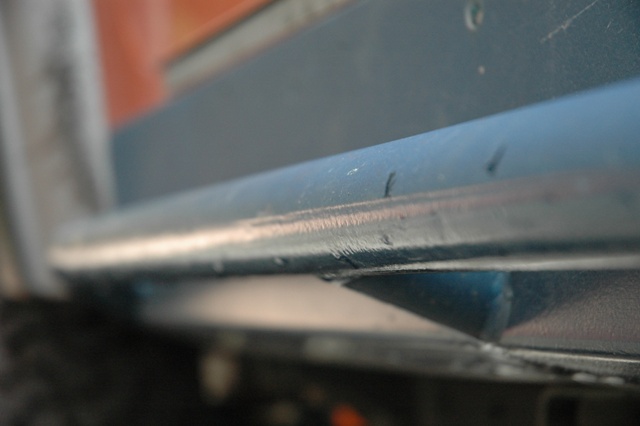

Yesterday I installed my front tube fenders. I am glad I did all the test fitting and drilling before they were painted. They went on very quick and reinstalling all the engine bay parts was not much trouble. The painter did an incredible job prepping and matching the paint color. I ground down the welds but he was the one that took care of filling the small gaps left. They are very smooth and I could not be happier with the outcome.
The LED holes are exactly what I wanted - and will look great once I get them installed. After I reattached the fenders, I used a paintable seam sealer on the wheel well side - I plan on painting the inside of the fender with (yea you guessed it) hammerite black to match the rear wheel well. I will also install a new rubber skirt to close off the opening to the engine bay - similar to the stock one - more on that later in the build.
I know that some people like the welds to be left untouched on the fenders and corners - but it was not something I was crazy about. I appreciate a nice looking quality weld, but the TnT welds while strong were on the ugly side and I only spent $300 total to have the fenders and corners prepped and painted (including the LEDs)!
Here are some photos -
I thought it was a good idea to create a drain inside the tube since there is potential for water to get in through the LED holes. You can see the hole at the low point of the fender tube.
Here is a shot from above and one with the hood open showing the relocated engine bay parts.
