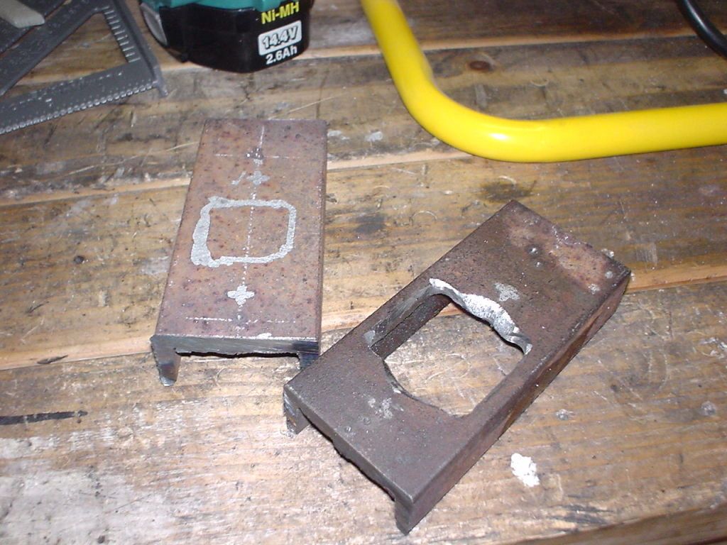

Originally Posted by cmecha View Post
i'm looking for a new front Lower shock mount that i can weld on.
I've made two sets of bar pin shock mounts out of C-channel stock....it's not hard....
...more.
