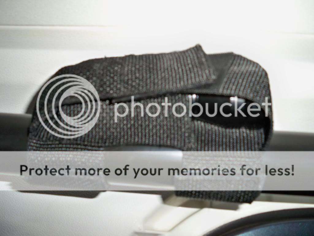

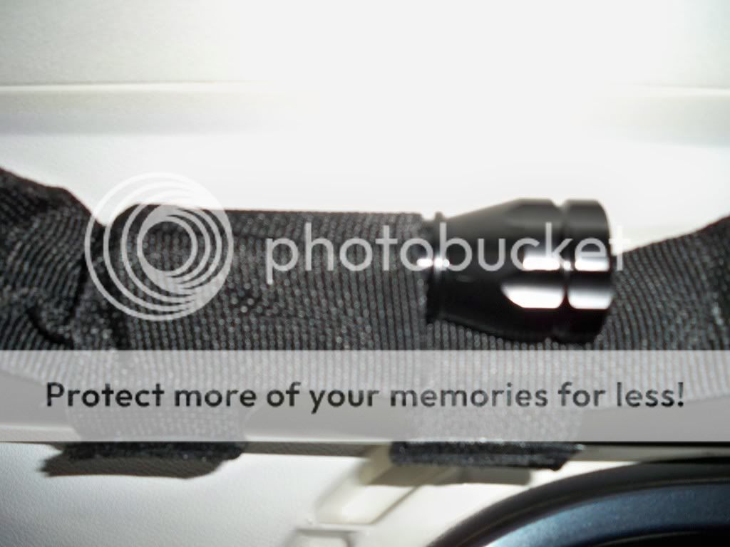

I made a flashlight holder for my bad *** flashlight i got for Christmas :thumbs up:

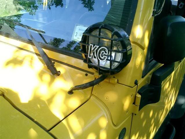

Has anybody ever built windsheild light mounts? If so could you post some pics?
I was told that you could just mount the light directly to the windshield by removing one of the torx bolts from the hinge and screwing it back in with the light bracket. This does work for sure but now my lights point to far off the sides and I can`t rotate them. Kind of pointless to light up the ditches. So I was hoping to built some sort of mounting brackets instead of purchasing a KC light mount.

here we go..

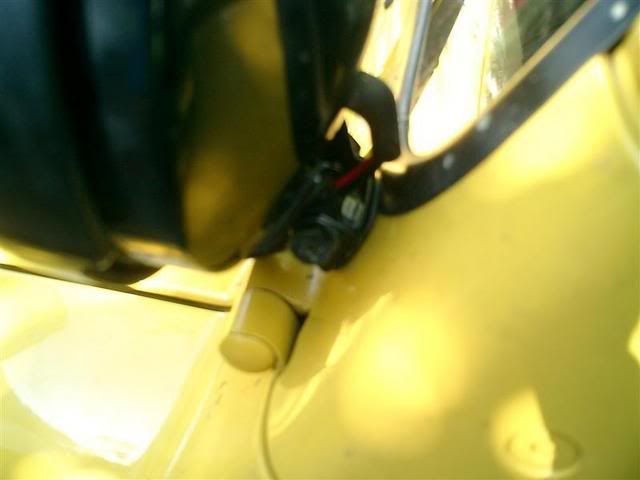

Thanks
I mounted mine the way you described. They do point slightly to the outside, but they don't leave a dark spot in the middle, so I left them that way. If they did leave a dark spot I planned to mount a piece of angle to the windshield the way the light is attached and then mount the light to it; that would give you adjustability both up and down and side to side.
