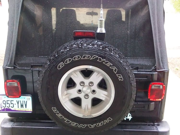

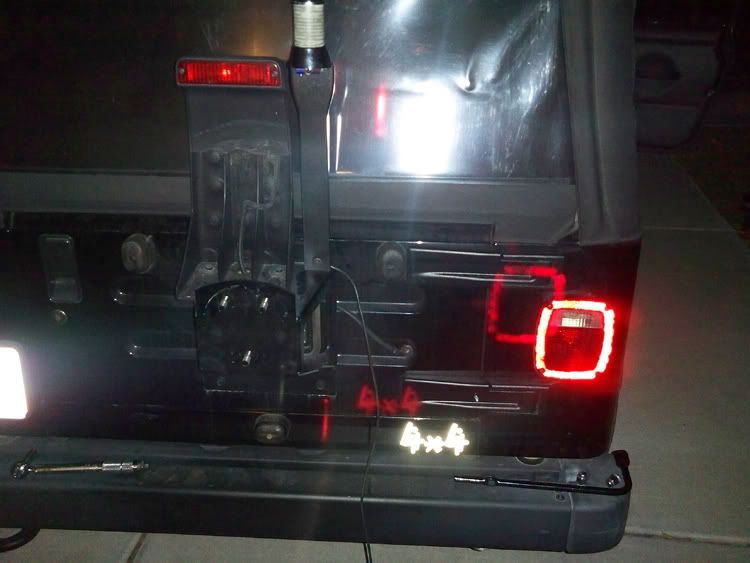

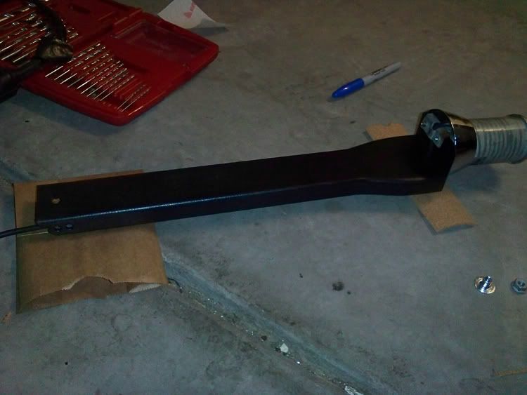

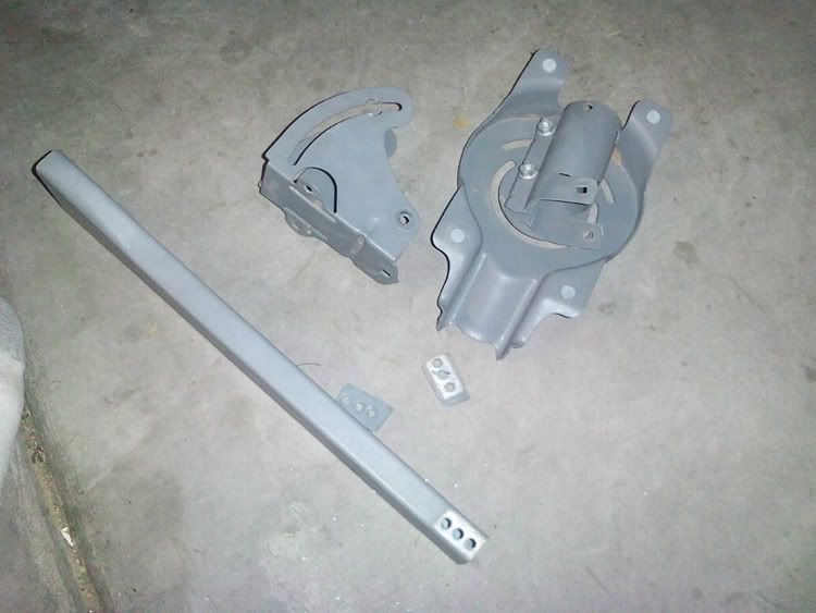

An antenna mount that uses one bolt on the spare tire mount.
I started off with one of these..
Thought and thought and thought about what to do with it. I did not want to Drill any holes in the jeep. So I ended up with this.
I went out and bot a grade 8 flange bolt to make up for the extra length needed.
Lots of cutting, sanding, fitting and painting. This is the final product.
Mounted at 27ft lbs. I ended up using a stack of washers on the inside of the mount to prevent it from folding at the factory torque.
100% Finished.
All in all costed me like 5 dollars. I will not post the full build detail on this thread.

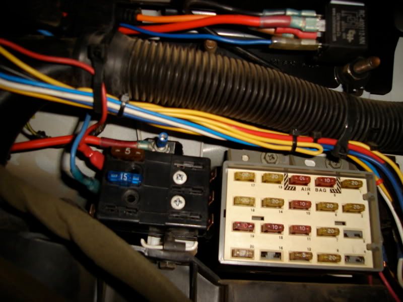

temp gauge bezel from airbag switch
aux. keyed fuse panel
both were done during my aw-4 swap.
