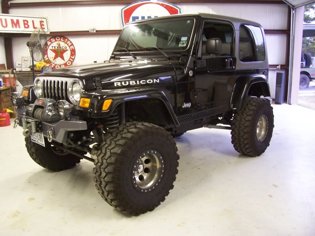

heres some pics

Im going to test it out on some trees this weekend to see how strong it is. I covered it with por15 which says it wont chip but i knicked it with my ratchet and it is already missing some paint.

I also couldn't decide if i wanted it silver or black but i alreadyhad black and wanted to see it finished. Anyone think it would look better silver?

you going for looks or function? Leave it black.
Personally, I think the stinger needs some reinforcement higher up if you want it to be a sturdy stinger and actually work in an endo situation.
Definately needs reinforcement. It works fine for show, but if you're in a situation where a lot of the Jeeps weight is on that stinger it will bend, especially since most likely it will hit it or bounce on it.. It won't add much weight at all and will more than double the strength. Just PLEASE get a tube notcher and don't use just a cut off disk. Looks so cheesy and "homemade" when people do this and just splooge a 1" weld on the sides to fill in a gap.
Also are you going to put a winch on that? The way it sticks out it looks like it would be in the way for a cable.

What did you use to bend the tubing?

I had it bent at a shop. I wanted to make a grill hoop also or when i can afford my flat fenders i wanted to tie it into the shock towers like nomercys rubicon
That would definatly give it the support it needs

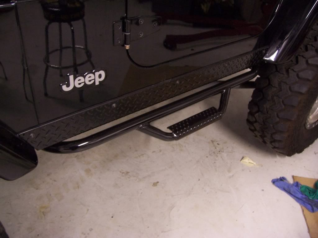

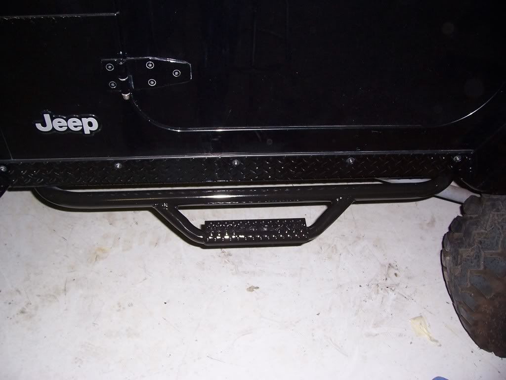

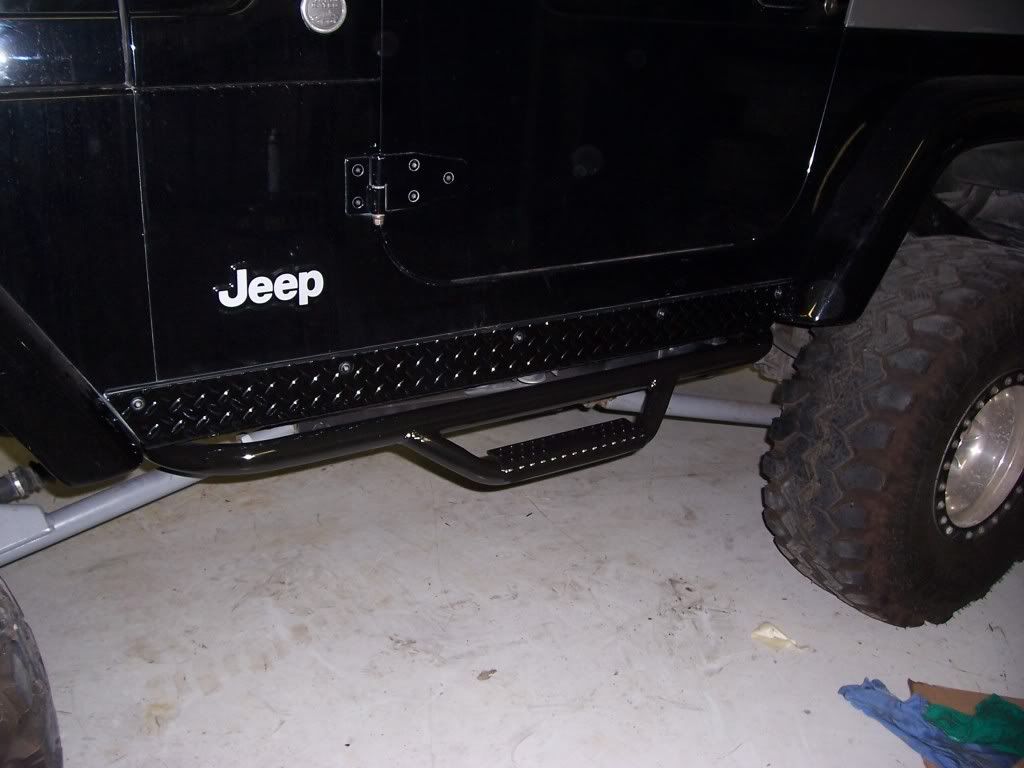

I built a set of steps for a local jeeper. I used DOM for the side bars and some n-fab steps that i had laying around.
this is before

post #1452 of 3576 Old 12-18-2008, 12:57 PM
bluox3
Location: nh
Posts: 159
i like the steps...theyalso might keep the wife happy
