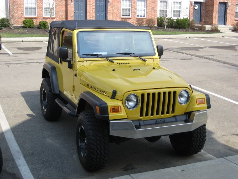

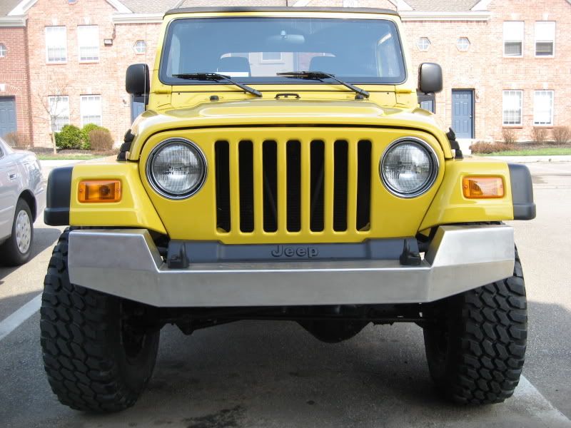

Home made front bumper... I did this awhile back, never thought to add it to this thread til now.
I plan on adding a hoop, clevis tabs and winch. Waiting to do all that until I get the funds for a winch. BTW it's stainless and I plan on powdercoating it after everything is done.
