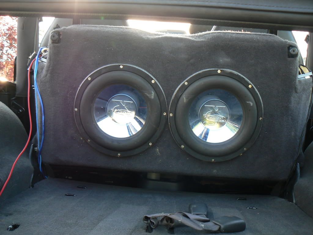

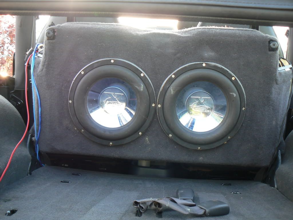

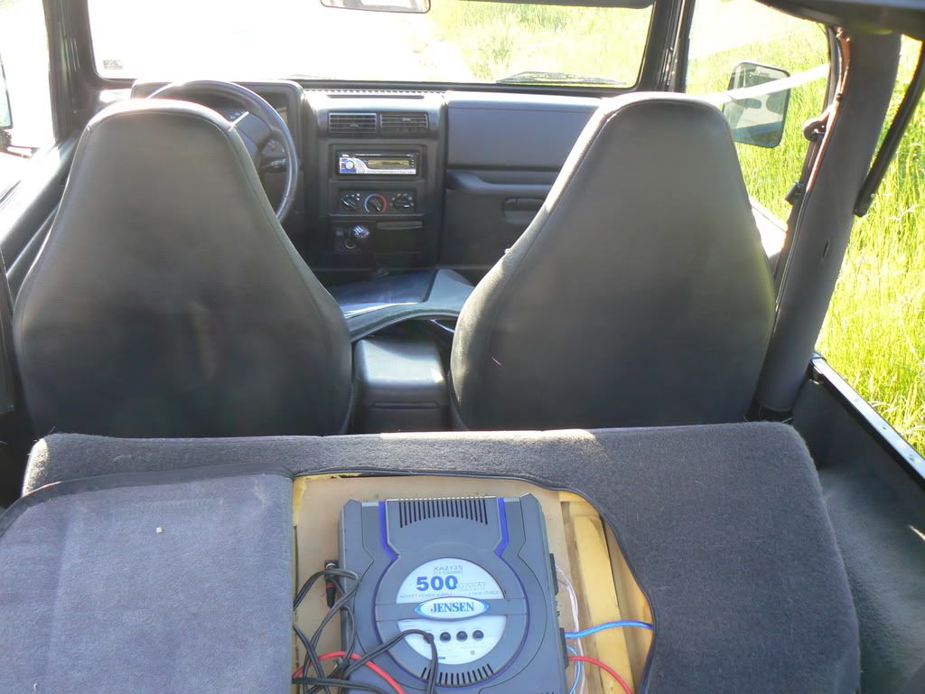

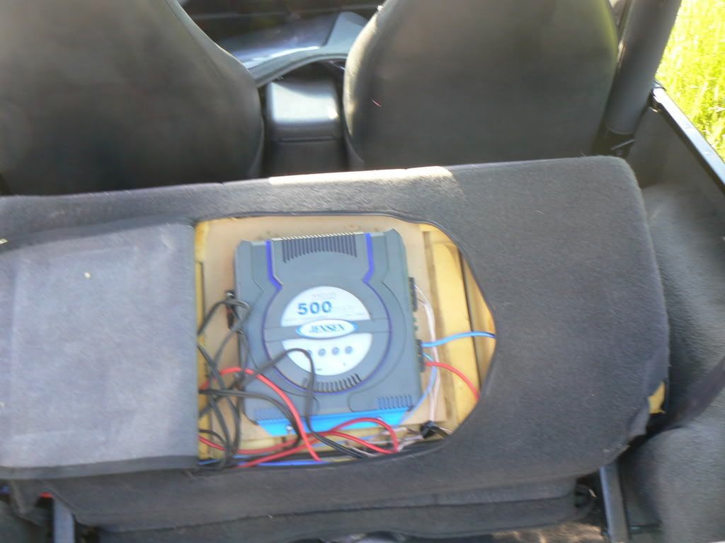

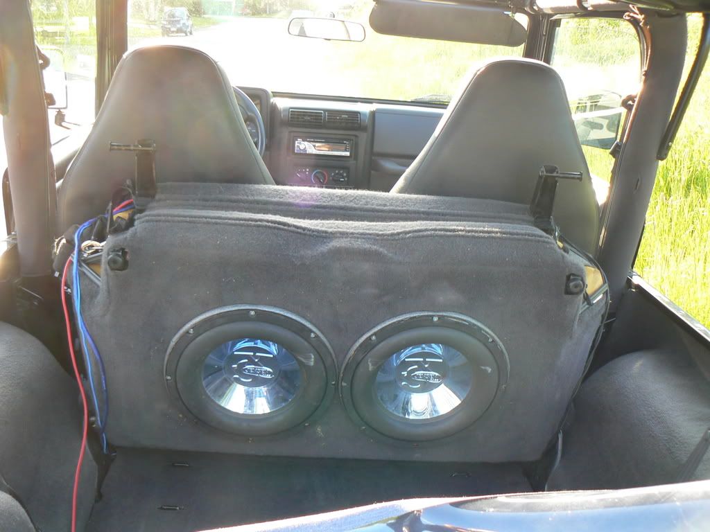

Custom Sub and Amp Seat
Hey.
I really wanted a stereo in my jeep but really didn't want to lose what little space there already was. So i put my 2 12" subs and amp in my rear seat... I just took apart the bottom, shaved off a layer of foam and build a box that fit in the seat. Same thing for the amp really. Seat still tumbles and is functional, just some added vibrations for back seat people
Best part is it looks like I have no system, so I'm not to worried about equipment theft...

That is the best speaker box idea i have ever seen seriously... and i used to work at a custom audio shop... how is the sound quality?
I bought my jeep in mid may '08; ever since then my girlfriend complains i spend to much time working/playin with my jeep....She says, "I'v Been Replaced by a jeep :("
R.I.P Nathan Fogerty
fogertyb is offline
post #973 of 3576 Old 06-11-2008, 09:23 AM
genuine
Location: Victoria, B.C.
Posts: 23
The sound's pretty decent... it would have probably been better if I would have used 2 10" instead of 2 12" because there's not enough airspace in that sealed box... but still better then nothing
