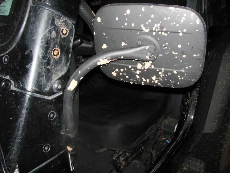

Here is a shot of my "doorless" mirror.
Sorry for the mud.
All I did was use a preformed 1/2 conduit elbow from the HD.
I inserted a 3/8" nut into one end and bent some tabs over with a chisel and created my own nutsert.
Put a 3/8 x 2" bolt up through the hinge.
This thing works like a charm.
89 YJ, 4.6 Stroker, SOA, Waggy 44 and Ford 8.8 w/ARB's. Rollin 35" BFG's. Raptor Lined Body.

probesport
probesport's Avatar
Join Date: Aug 2004
Location: Metro Detroit, MI
Posts: 328
Sorry for the mud.
Click free, and don't ever apologize for mud again.

Oh man, did I say mud.
That is actually a new color of paint that I am trying out. If you look, you can see where I got it on the body too!!
