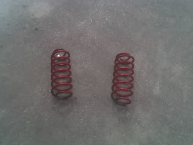

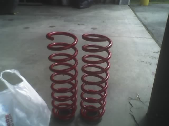

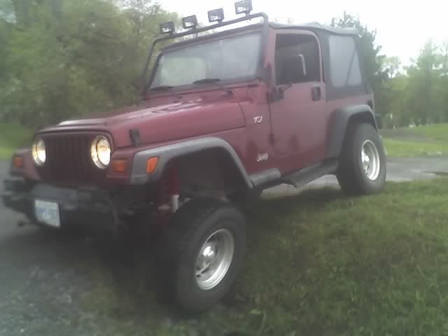

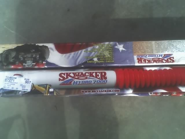

"custom" suspension lift
ZJ Coils
CV police interceptor coils
Skyjacker hydro's
Sway bar discos
Rear track bar bracket
Action shot
Took me about 6 hours to do entire lift, then about another hour to align it enough for now.
next weekend, some longer sway bar links will be made!
2000 XJ 4" 33's... TJ on 1 tons and 40's after Afghanistan!

heres are my rough measurements:
left rear: 4"
right rear: 3.75"
left and right front: 3.25"
this is without the hardtop on and a half tank of gas. i expect the rear to settle a little bit more.
if not then i will be taking the ZJ spring isolator (adds .25") and will be placing it on the right rear spring.
I will also most likely put in 1" coil spacers for the front to level things out.
Not bad for under $450 for 3.5" of lift in Canada!

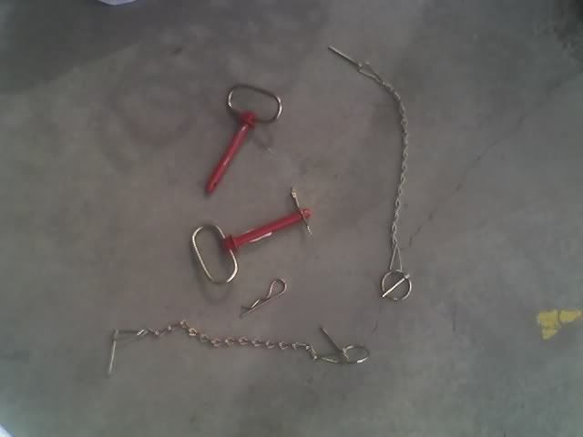

Do you have another pin through the inside end of the lynch pin to keep it from coming out unintentionally? Or does it screw in? Hard to tell...
If it just pushes in, just thinking that once the weight of the tire and accessories are on the carrier it might tend to come open at random, especially after the pin starts to wear... Does it have threads or is it something like the end of this?

Looks like it is threaded, if you look closely to the rear of the bracket.

It has a nut welded to the inside plate and it screws in to it to hold it in place very strong set up the screw in part also has a carter pin in it . The swing in plate is also sitting on a 1in riser welded to the bumper . the screw in hand part only holds it in place , the swing out is resting on the bumper .
