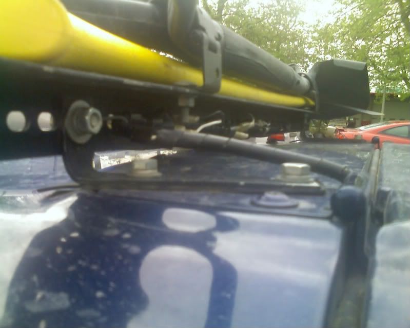

Here are some more shots (with crappy cell phone, sorry)
Detail of my bracket. used an 5" shelf bracket. I put a slight twist at the base of the verticle portion so the passenger and drivers side were parallel in order to mount the cross bar to a flat surface. Did this after they were mounted to the jeep so I could get them close to perfect. Washer jet can be seen just to right of front hood bolt. Can also see a piece of rubber I have sandwiched between the bracket and hood hinge. Been meaning to trim it back some.

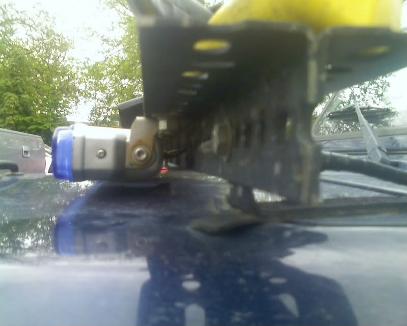

Can see the washer jet just under the backside of the light. Jet is about an inch forward of the cross bar. Cross bar is about 3/4" above jet.

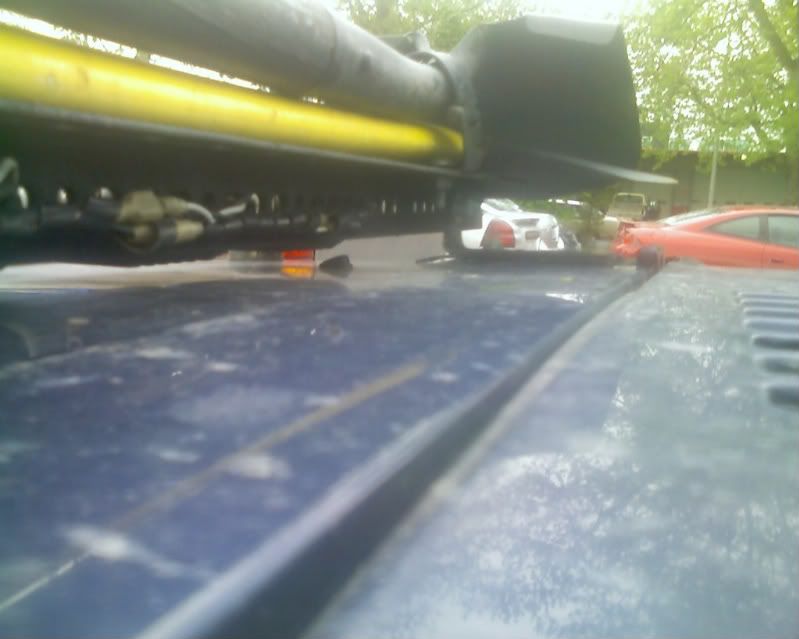

Nice overall shot. can see bracket and pass side washer jet.
Another just to show clearance to washer jet.
