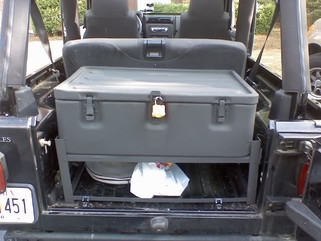

I made this locking storage system for my LJ. Got the box from army surplus. Had a water proof gasket, which is removed for the time being. Had to install hinges on the back, and lock on the front. Built the stand out of aluminium angle stock. So i get storage underneath, and can lock my laptop in the trunk. Which also holds my safari top. Trunk is secured using plastic covered steel cable, and the stand is clamped down to the bed using the rear bed tie ins. Under storage is secure by keeping the tailgate locked. Its about 95% done, but good enough for travel and security.
I may add walls to the lower shelf unit, to help protect from rain, and/or add a drawer(s).
I'd be careful about storing a laptop in that box during the warm months. I'd wager it could get hot enough inside that box to fry some of the more sensitive components.
Mike

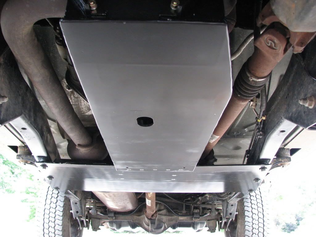

Originally Posted by AROSETO View Post
Scotch740, what does your skids look like. I see most of yours are homemade.
Thats what mine is like, Most of my projects listed in my sig are a link to my write up.
Scotch740 is offline
post #824 of 3576 Old 04-28-2008, 01:15 PM
AROSETO
Location: San Jose, CA
Posts: 275
Wow, that's sweet. Way more heavy duty and time then mine. I don't have a welder. Plus I am using stainless since it was cheap and available for me from work.
