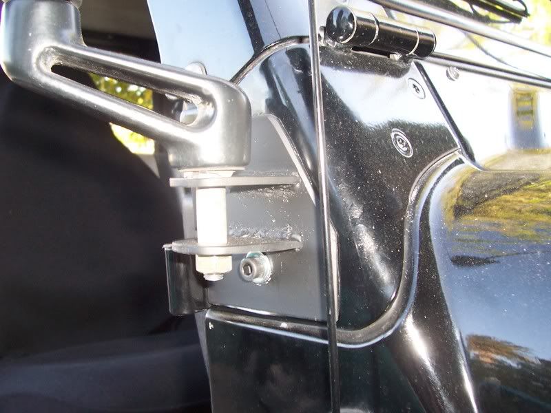

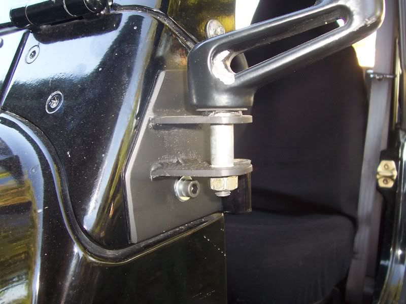

I built these mirror relocators for next to nothing. Copied from ones i found on Quadratec.com.
http://s23.photobucket.com/albums/b3...t=100_2835.jpg
http://s23.photobucket.com/albums/b3...t=100_2834.jpg
Black Jeep Society RIP 99' tj
cal45acp is offline
post #789 of 3576 Old 04-10-2008, 10:22 PM
Keelentime
Location: Salmon, ID
Posts: 187
clicky no worky
Nice!
May I suggest, put a sleeve between the upper & lower tabs so you can tighten the nut without it pulling the tabs together. This will also help keep the nut from coming loose.
