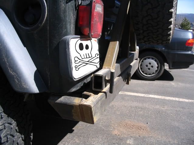

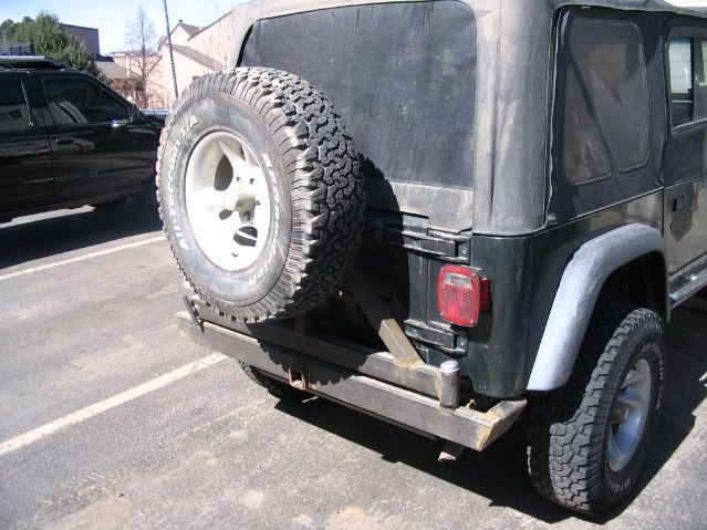

Posts: 403
Originally Posted by Keelentime View Post
Looking for those pics. I am planning on one myself, and can't seem to find enough of them (200+ posts just aint enuf)
Here are the pics for you I'm not quite done yet. It'll have a cargo rack and two fuel can holders as well. I'm installing the clevis mounts tomorrow.
98 TJ- Kilby gastank/ steering box skids, Sky jacker high clearance tcace skid, 1'' BL, M.O.R.E. 1" MM's, Poison spyder rocker guards and sport cage, Warn XD9000i on A to Z fab Winch plate, RE 2" BB, Nth Diff slider, Quick disco's, PSC Rock Ring, JB Conversions Super short SYE kit, and a burly CV Drive shaft.
LOTS more to come
I wave, Do you?
wheelinman03 is offline   Reply With Quote
Looks great! Very inspiring!
Just Keele-n-time.........
[QUOTE=robncar;5113545]It took me a while to realize urine was yellow and shouldn't have blood in it[/QUOTE]
Keelentime is offline   Reply With Quote
Thanks, I just had an idea of what I wanted in my head and started with a 7' 2x4 and went to town... lol It'll look alot better when i get it powder coated...
LOTS more to come
I wave, Do you?

Posts: 403
Originally Posted by JEEP97TJ View Post
Dang that looks good. I like the corner protection. Good Job
If you don't mind me asking, how much $$ do you think you have in it--unless you got the materials for free
Thanks I built it alittle wide to protect those corners. Its about a half inch out on each side. As for whats in it I don't mind at all lol some of the steel I got at a local scrap yard for cheep. Ie 1/4" plate for brackets and boxing off the ends of the 2x's. I got the 7' 2x4x1/4" for about $100 and the 4' 2x3x1/4" for about $40. I bought these new because I wanted them to be straight. Plus good luck finding any nice pieces like that at the scrap yard. The 2x2x3/16" was scrap from work. The hinge was $44, the tire plate was $20 (I bought that cause I was lazy), and the bumper clevis mounts were $20 for the pair. So I've probably got about $230ish in it if you include a few flapper discs for the grinder.... But I also get the satisfaction of saying I built it and the bumper is 1/4" steel not 3/16" like most aftermarket bumpers. AtoZ Fabrication has a lot of premade parts for bumper fab. That’s where I got my hinge and clevis mounts.
LOTS more to come
I wave, Do you?
