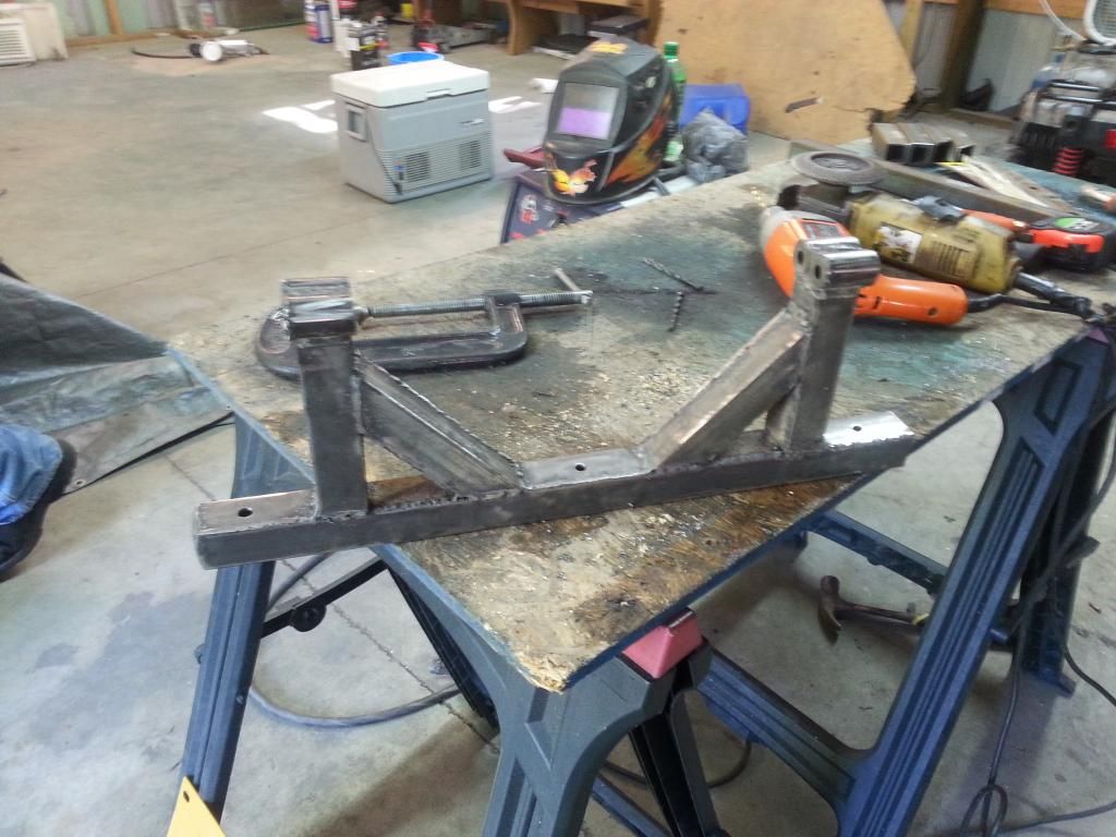

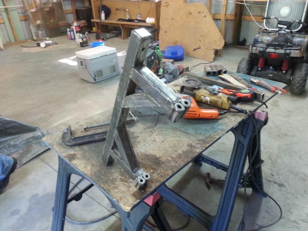

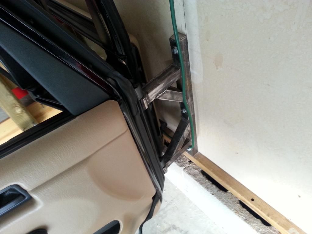

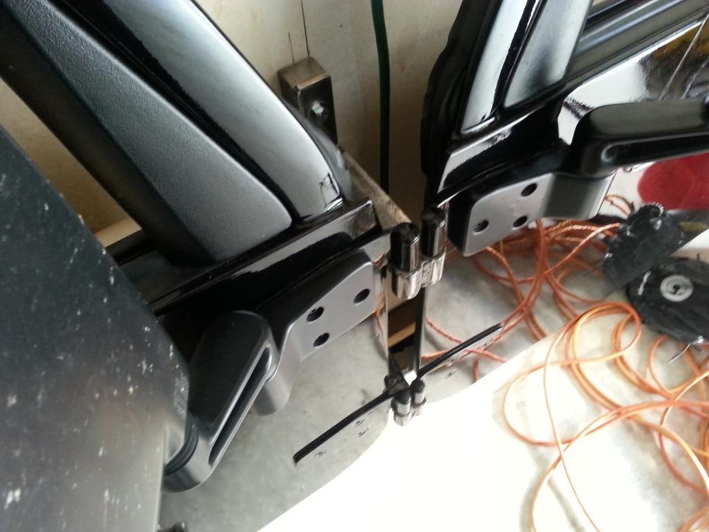

Made some door hanger brackets (total cost $2.50 for washers and lags)
I got some 1" angle iron (for free) and welded them into a box, cut everything up, my brother-in-law had some old wrist pins laying around so we welded them together, cut them in in half and welded a washer to the top for the hinge pins.
Welded everything together
and came up with this

so are you going to mount latches to the wall too? then you could make a cubby for cool stuff behind Door#1 or Door#2 haha
A latch is possible just to keep the kids from swinging the doors around and beating them up... but no hidden compartments
