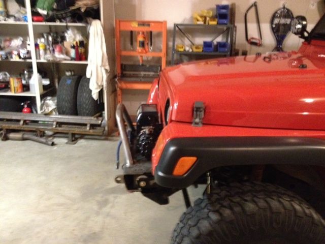

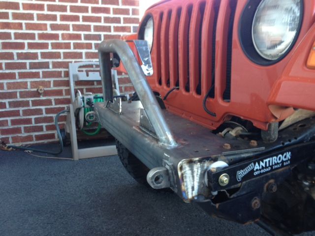

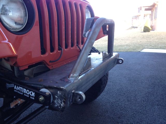

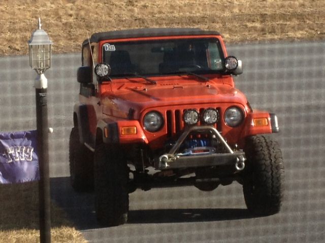

Ready for sandblasting and paint. Ground the weld splatter off and the end caps smooth. Rest of the welds are not ground at all. 15 deg rake on the front and hoop. All 1/4" GR60 steel plate and 1.75 x 0.120 wall DOM. Lugs welded both sides, the "T" has a 15 deg to it too inside the bumper. Wasnt sure I would like the lights up top but in person it looks great! And the end caps fit the anti-rock very nicely. Tell me what you think!
Man that looks awesome. I'd like to do that with mine.

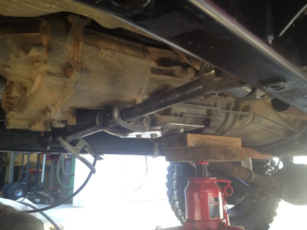

**** I forgot about this thread. I made a transmission crossmember.
Best pic I have. Before welding was done and paint.

Thanks man! I am really happy with how it turned out. And since I made it out of scrap steel I only had to pay for the DOM and weld consumables. Oh and a sixer to the guy that bent it. We didn't have a gooseneck die at work big enough to bend it like that. This was my first "real" fab project but the welds came out pretty good. Did lots of little stuff before though. I'll post pics when painted and the winch and lights back on.

would make dropping the Trans so much easier than working around the huge stock skid plate/ transmission cross member.
