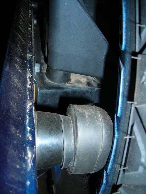

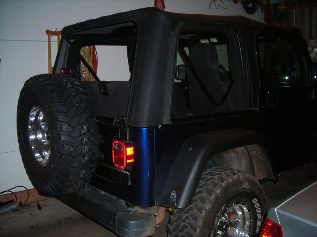

Not a really big deal but I bought some rubber isolators (those things are really hard to find! ) and I extended my bumpstops. Because of the backspacing on my wheel, I had to sand sandwich two 1" isolators together and sand one of them down. I did this on the left and right hand bumpstops on the tailgate. The bottom was fine.
I also raised my 3rd brake light.
The tire fits much better now and it is only slightly harder to clost than a stock tire. So I'm not worried about it. It's temporary anyways. But it's definitely a requirement (IMO) if you are going to mount a larger tire on your tailgate. Otherwise damage could occur really quick. It isn't really pretty, but I'm not trying to show off my bumpstops anyways.
