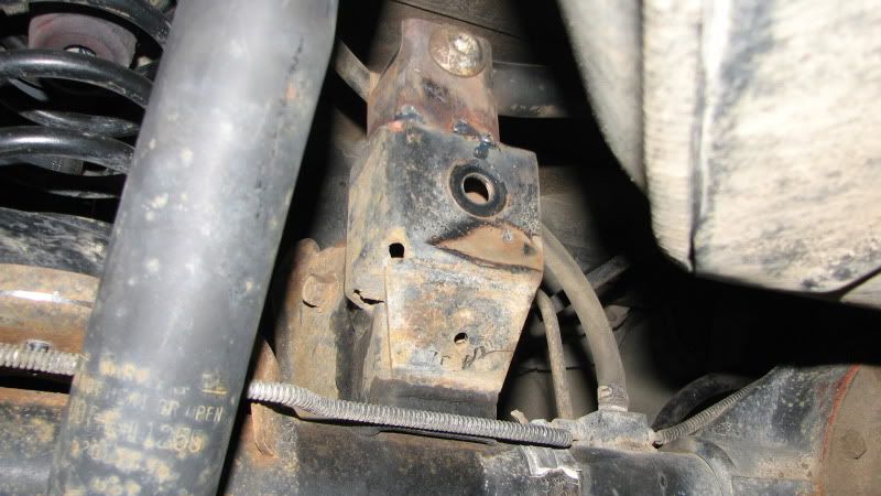

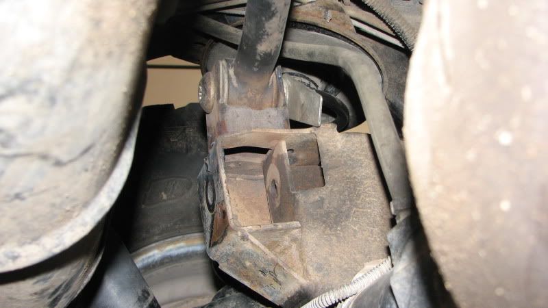

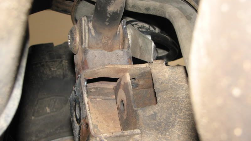

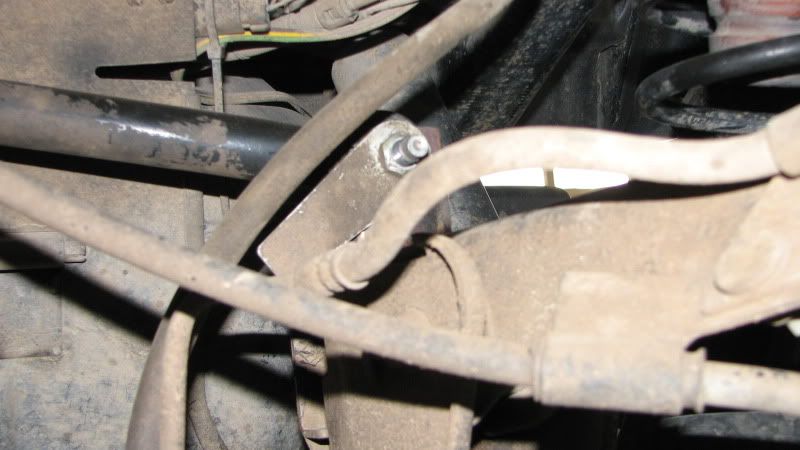

Home-made track bar mount
Rather than spend the $$ on adjustable bars, or even bolt on extensions I went this route, much beefier than original.
This has my rear end "spot on" as far as centered after lift.
(now how to keep my pants up with-out suspenders)

Buy it? Why? I have a welder! Love the trckbar upgrade I am thinking about taking my stock track bar and cutting an end off then sleeving it, and put a heim on the upper end. tadah adjustable!

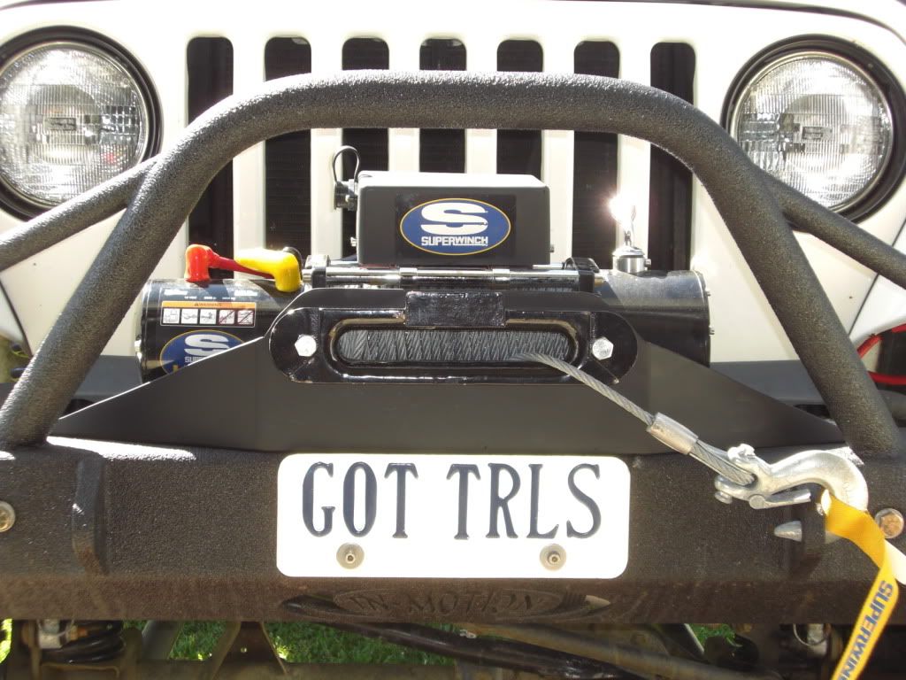

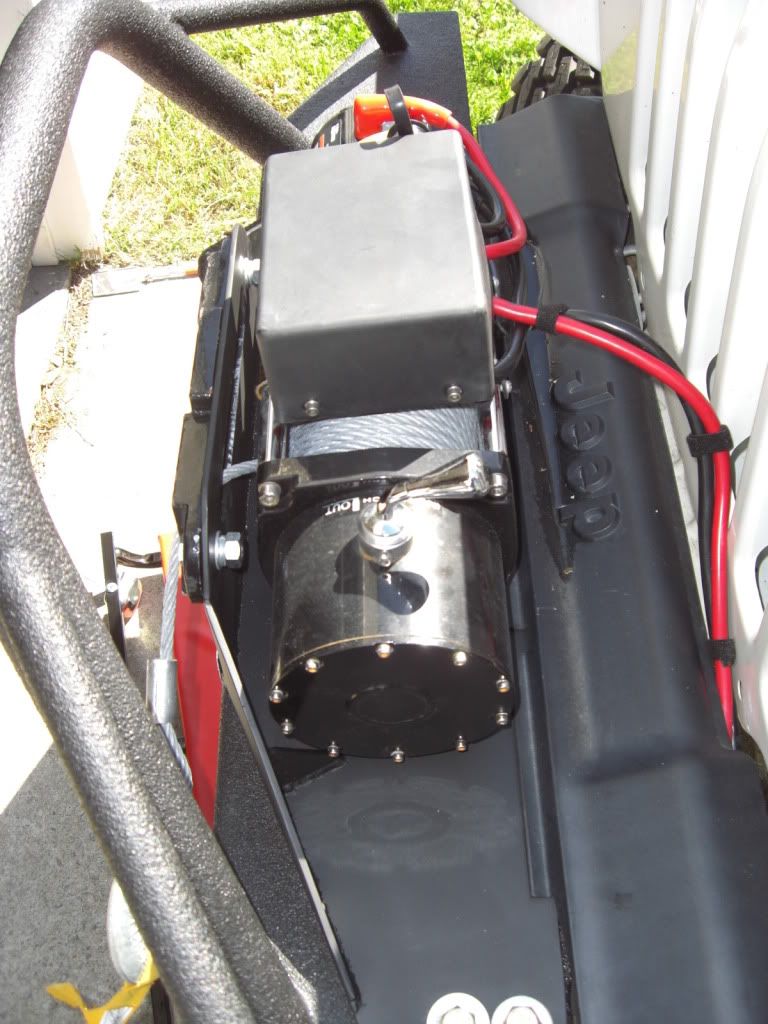

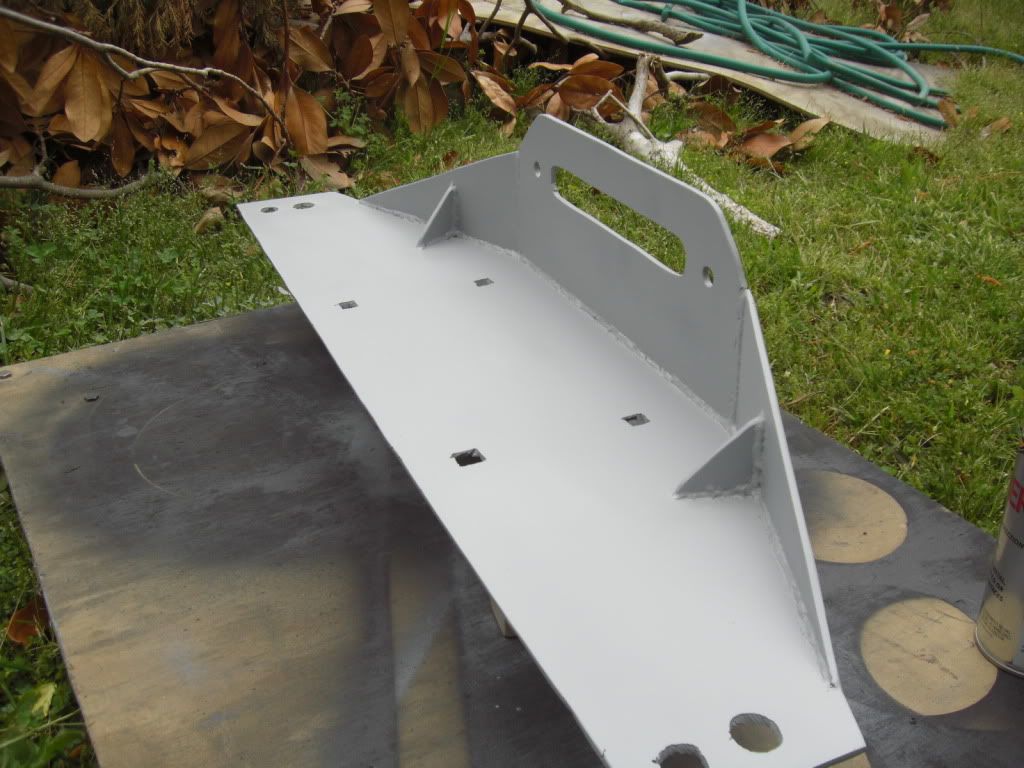

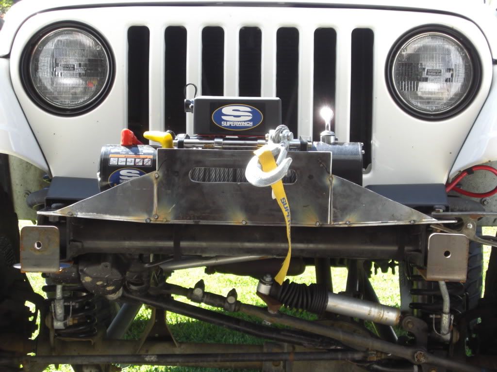

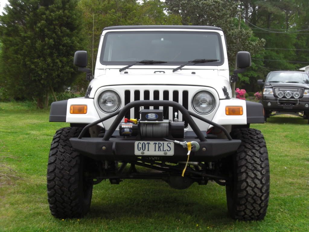

From this to building a new winch plate mount

I was thinking the same thing, , this was easier and I was running short of time. Still may do that though.

That looks a lot better and safer!!!!
Really nice work man!!!

That looks great! Now you are good to go wheeling! Let us know how she holds up when you get to use her.

/\ Ditto, nice job. Now add a roller lead and your all set.

looks good, (but) your fair lead is to high! in relation to the lower part of the drum. you will be pulling your winch in an upward force while spooling under load.
the bottom of the drum should be center of the fair lead.

Yeah absolutely right...

You won the nicest mail jeep award.

You know i noticed that is was high after i painted it up but that can be changed in about a week or so i don't have the time right now but i'm going to lower the fairlead to where it should be.

__________0 the line is the cable and the 0 is the drum you want your cable and the bottom of the drum a clean and level. you have it something like this
--------o

I noticed that mine seems to be like this on my Currie with the fairlead (---0). The hole in the mount is big enough that I should be able to drill lower although I feel like I shouldn't have to. Guess I should have waited for one better to have come out a couple of months later.

I see what your saying
I'll take care of it next week.
