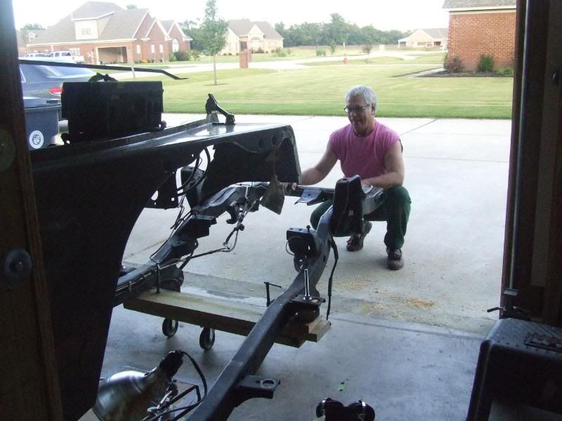

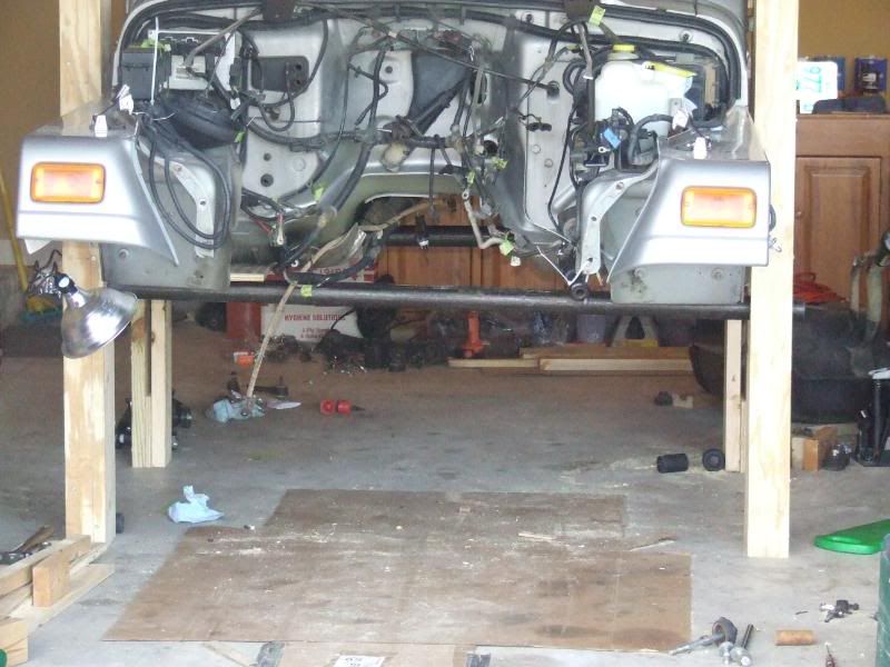

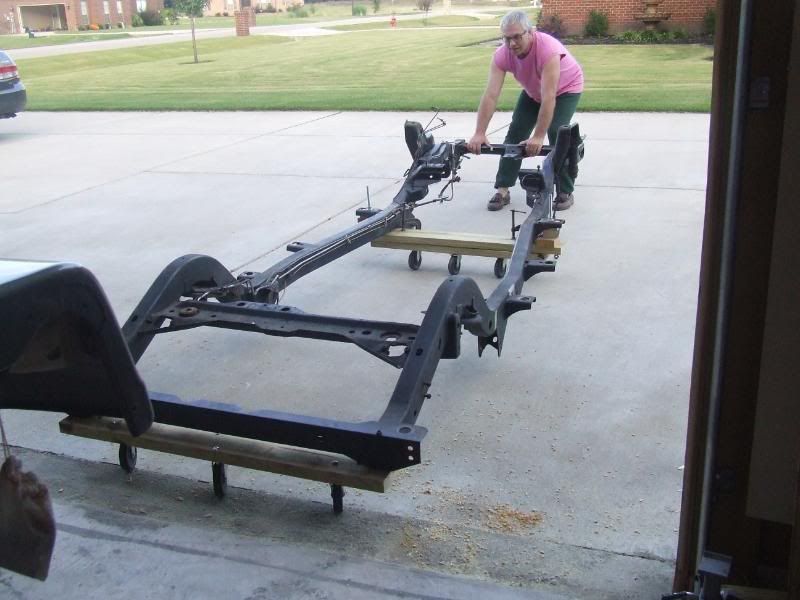

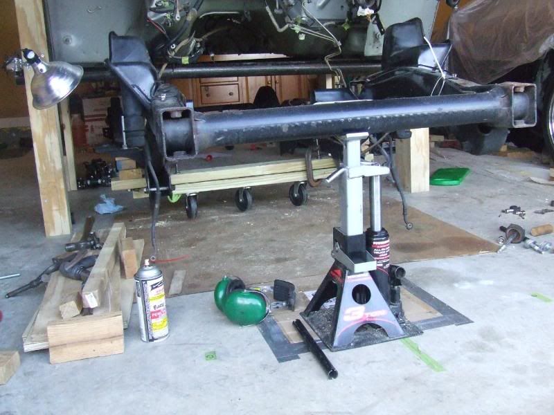

Body support and roller skates
Found bad cancer in the frame...needed to replace the frame but I don't have a shop here so I had to improvise at the house...don't ask about the economics of replacing a frame...it's still cheaper than replacing the Jeep.
Front skate
Just clear
It worked !!!
Body support works good

Nice, pulling the frame out from under the jeep.
Gonna mod the new frame, or replace with like frame?

Stock frame from another TJ. Drove out to Collins Bros and picked up the replacment. Then, took it to Select-Motors in Pineville (Alexandria) Louisiana for acid dip, ecoat, and prime/paint. Should have it back first of next month.
While the frame is out, I'll take care of the few little rust areas on the tub bottom, finish my motor assembly, have the front and rear drives freshened up, then roll the new frame in and bolt her up.
