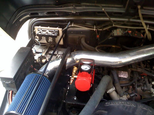

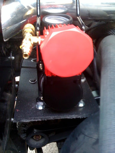

a mounting plate for onboaird air compressor
Made a mounting plate for a Q-Industries Super-Flow air pump to mount under the hood of my jeep. Plate is made of Nylon cutting board and mounts to the stock A/C compressor bracket (no A/C...but it has the bracket for it).
Hard wired and re-tapped the cylinder head to use 1/4" NPT fittings.
here is a closer shot

Nice way to mount it, I ordered one of those from 4wd.com and I was looking on where to mount it, and you've answered it! I'll also be retapping mine for 1/4" NPT fittings.

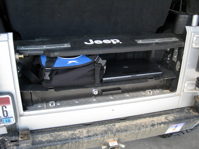

I was looking for a way to secure my laptop during the summer if I had to stop somewhere on the way home (groceries, drinks with the guys, etc...) so I modified my Mopar insta-trunk to be more secure.
Since I bought a full length Tuffy drawer (a cheap ebay find) I had to modify my insta-trunk so that it would still provide a flush surface but provide more security than originally designed.
I have screws and washers that go through a aluminum plate on the top to an aluminum bar that screw into each side of the Jeep's tub. It provides a safe, theft deterrent place to put things I don't want to disappear.

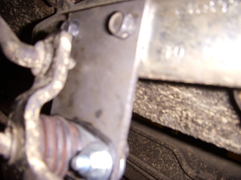

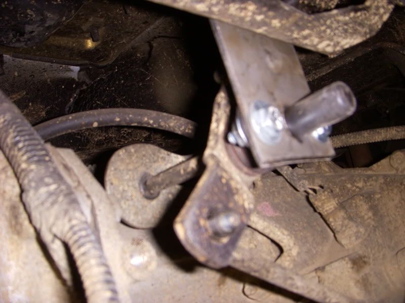

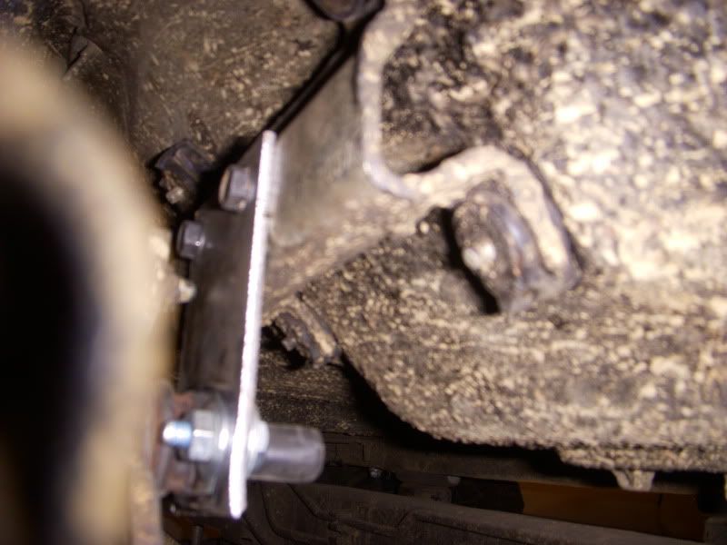

built a drop bracket for my shift linkage.. Now I can go into 4LO without getting under the Jeep.
