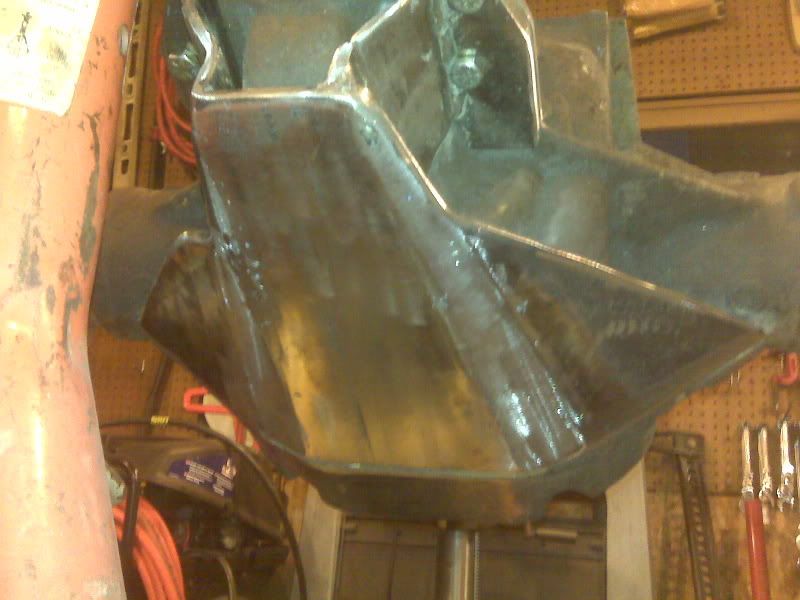

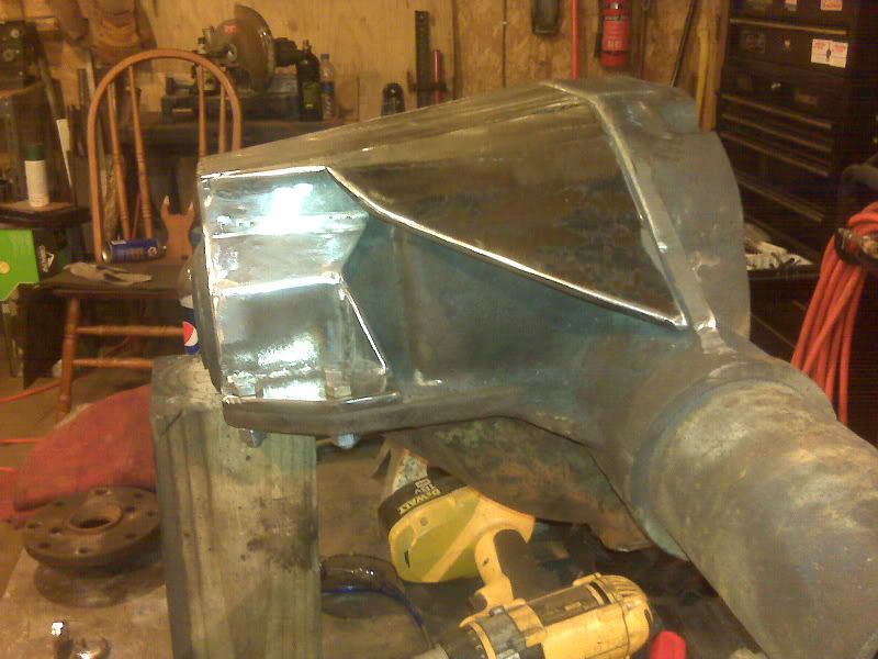

Ur welcome.
Looks like it will really hold up to those rocks though. Alot beefier than that Nth degree skid

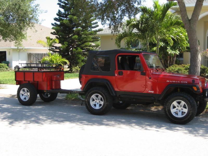

Completed my trailer !

Nice trailer!
binski
That trailer is awsome!! Do you have any "in progress" pics?

Started mocking up my 8.8... Even though I don't have the actual housing for my Jeep yet I did end up with a carcass out of a van, so I'm using it to mock up my axle truss etc. So today I built a skid for the bottom. I didn't want to shave the housing but I also remember from my previous Jeep that the big lip on the bottom of an 8.8 is nothing but a rock catcher.
So here's an upside down shot. I mounted the skid so it's flush with the lip...it's bolted to the housing using the webing...
Here's a shot from the rock's point of view...
thats rad!
binski
That's pretty cool. Are you going to add fenders to it eventually? Be pretty cool to have TJ rear fender flares or something on it.
There is a thread in the Fabrication group here http://www.jeepforum.com/forum/f37/trailer-build-almost-complete-732934/. Also in ROF under Techniques. Thanks

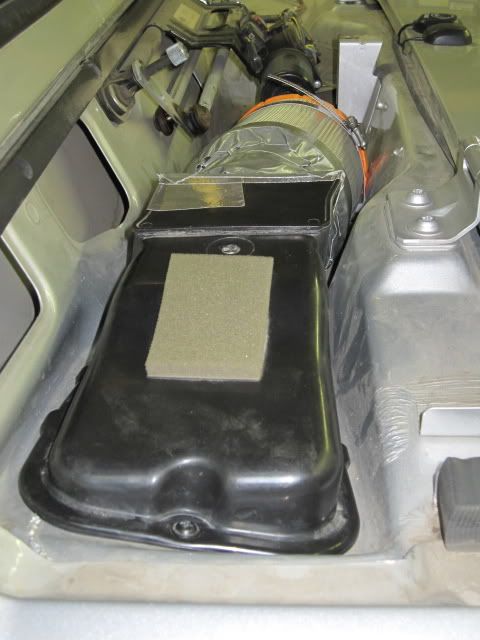

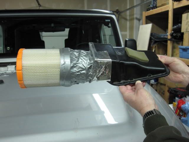

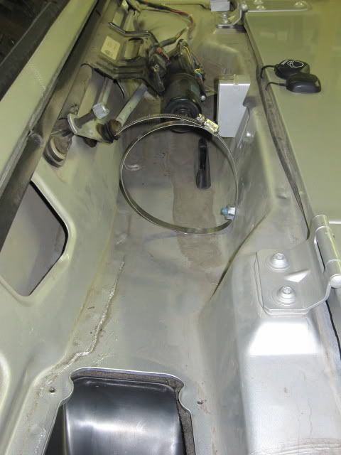

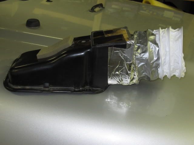

I made a filter for my hvac air so I won't be breathing dust when I move to AZ. It looks like something out of Apollo 13 but will be easy to replace the filter and gets the job done very well, hasn't restricted airflow either.
It may be ghetto. But it looks like it will work out. Good idea!
It's only going to work until he gets it wet. I did that once and the air passing through a wet filter decreased drastically. I'm going to do mine again this summer, but figure somethin else out.
also, why use duct tape when you can silicone it ?????
