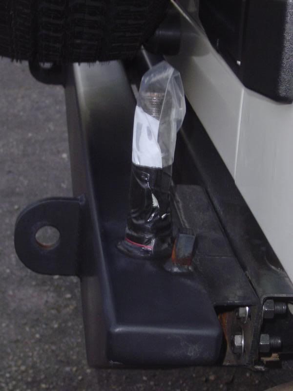

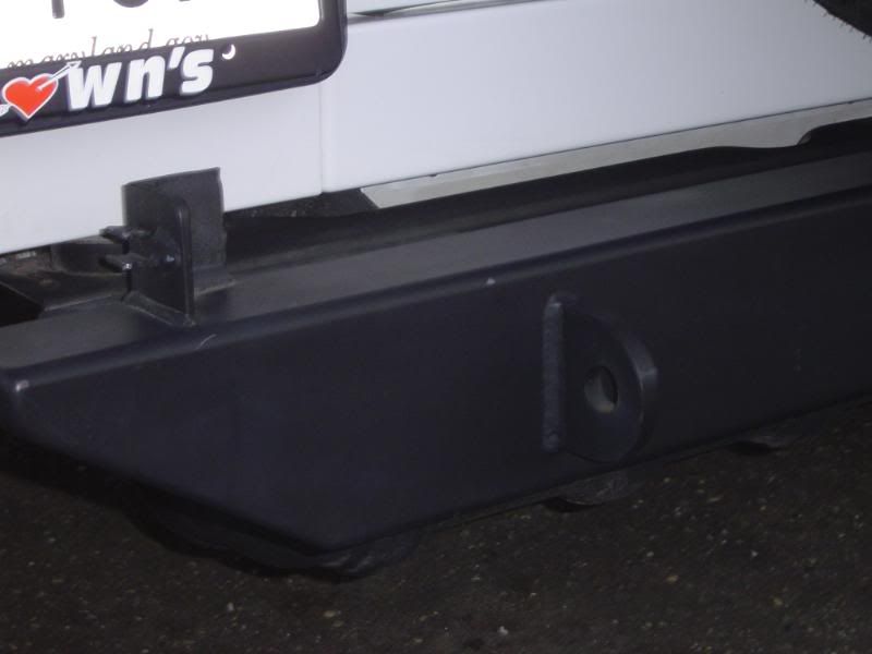

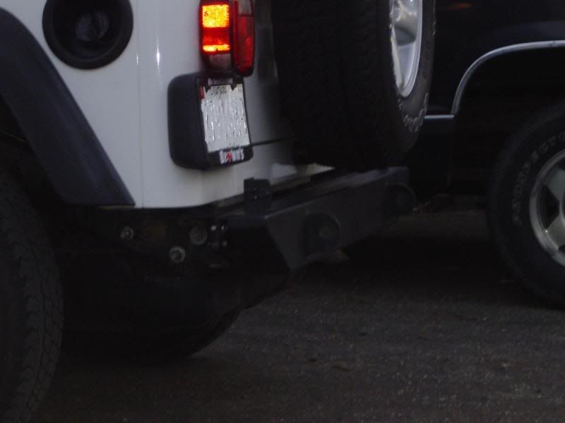

ok so I was bored today, no football, it was almost 70 degrees outside I decided to install a custom rear bumper that I made. I still have to make a few mods to the tire carrier(not yet installed) & the reinforcement brackets.
What Next?
2006 TJ Rubicon

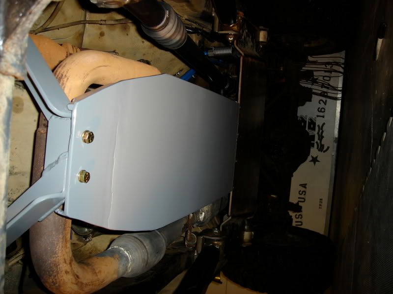

Originally Posted by Tim View Post

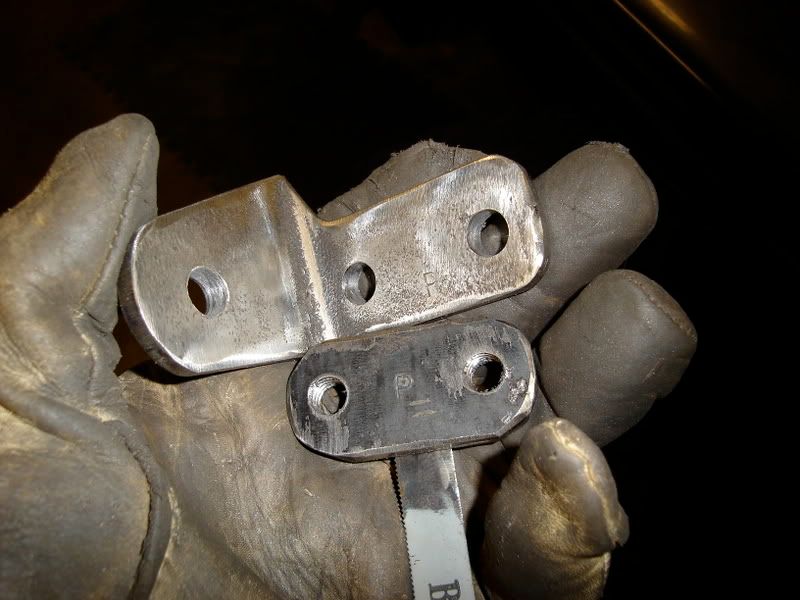

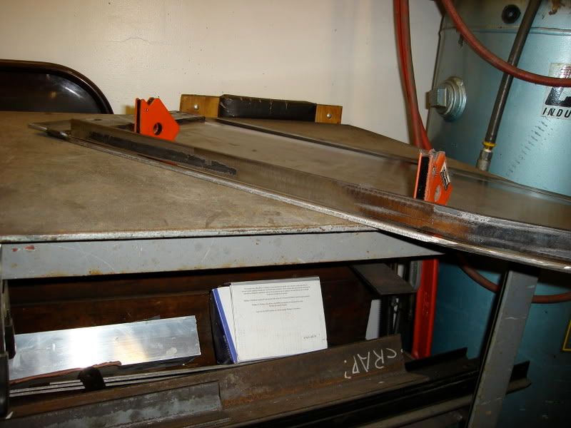

started an engine skid today..
i made these brackets to bolt onto the motor mounts. yup, those are hacksaw blades to hold the nut plate i tapped.
here is the beginnings of the engine skid. it mounts flush with the belly skid for a smooth transition.
right now in this pic, it is just 0.25" plate. i want to stiffen it up a bit with angle or strap welded down both sides.
couple more pix to go with the first few:
tapping threads for the bolts

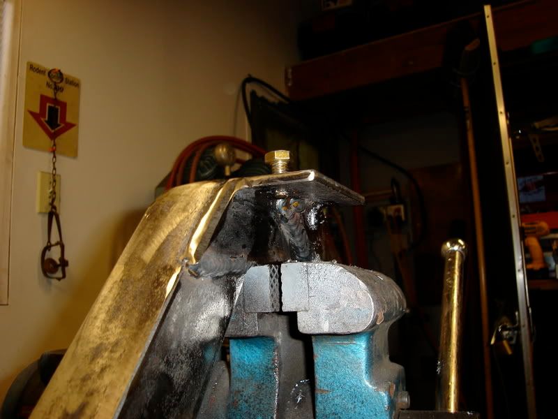

here is the front support with its paint still tacky. i may do something different here in the future although this will work just fine.
the engine skid getting some reinforcement.
this is my first try at building something like this, so far so good. i'll save the fancy stuff for next time
pics of it done will be coming... (someday)

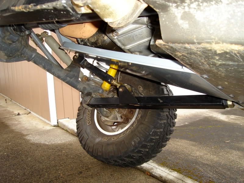

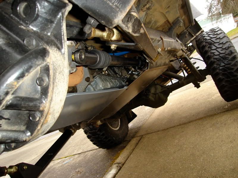

post #1669 of 3576 Old 02-09-2009, 08:37 PM
Tim
Tim's Avatar
Join Date: Mar 2003
Location: Longview Wa
Posts: 946

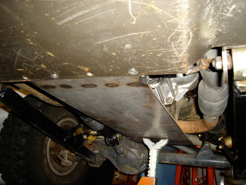

there it is installed. there is a write-up in the fab section of jf
Awesome work man!
NICE!
My only concern are those bolt heads, maybe end up shearing them off on a rock?

Originally Posted by dbbd1 View Post
NICE!
yeah, i picked some flush mount bolts on the way home from work today. i will install them this weekend

Nice job!!! Did you make the belly up skid as well?

nope, the belly skid is a clayton.

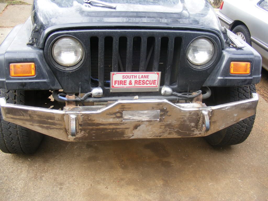

Almost got my new bumper finished. Just gotta grind a little more then put some paint on it and mount the winch
bigman7878 is offline
post #1676 of 3576 Old 02-11-2009, 06:31 AM
MUDY-TJ
Location: Melbourne Austrailia
Posts: 51
bigman7878
Are you going put a grill guard on it ??
Look's awsome btw

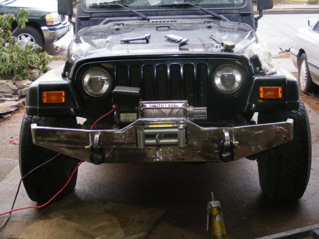

post #1677 of 3576 Old 02-11-2009, 10:58 AM
Rubiconmike
Location: Delta B.C.
Posts: 42
Nice job!
Whats with the ratchet on the hood?
I have scratches to but i only want the ones from the woods.lol
Rubiconmike is offline

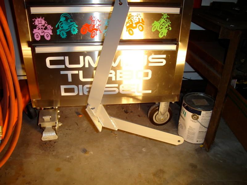

Originally Posted by GDTIME View Post
If you found more people interested would you be willing to make them?
Probably not, I'm over in Dubai in the Middle East so the shipping alone on steel parts would make people drop the idea because of the price.
Aside from the water cut face plate it was cobbled together from scrap material too

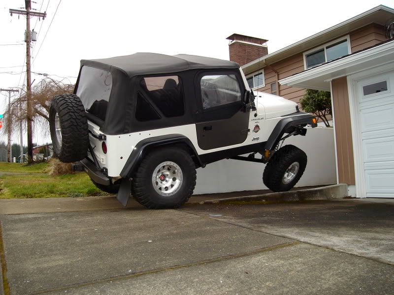

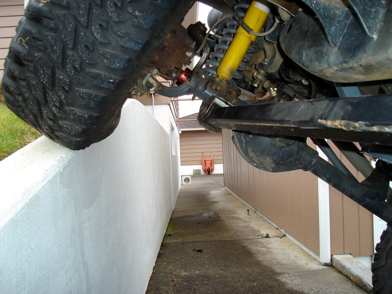

post #1680 of 3576 Old 02-13-2009, 12:57 PM
Tim
Tim's Avatar
Join Date: Mar 2003
Posts: 946

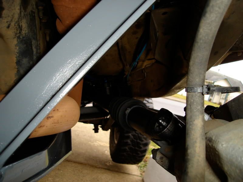

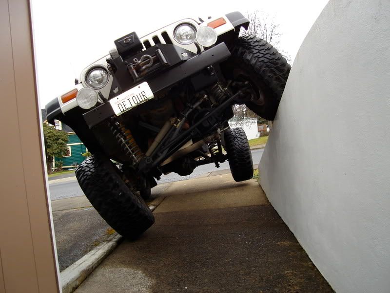

no clearance issues what-so-ever! plenty of room for everything. i drove the jeep up a retaining wall until the d/s rear came off the ground.
here's a few pix:
