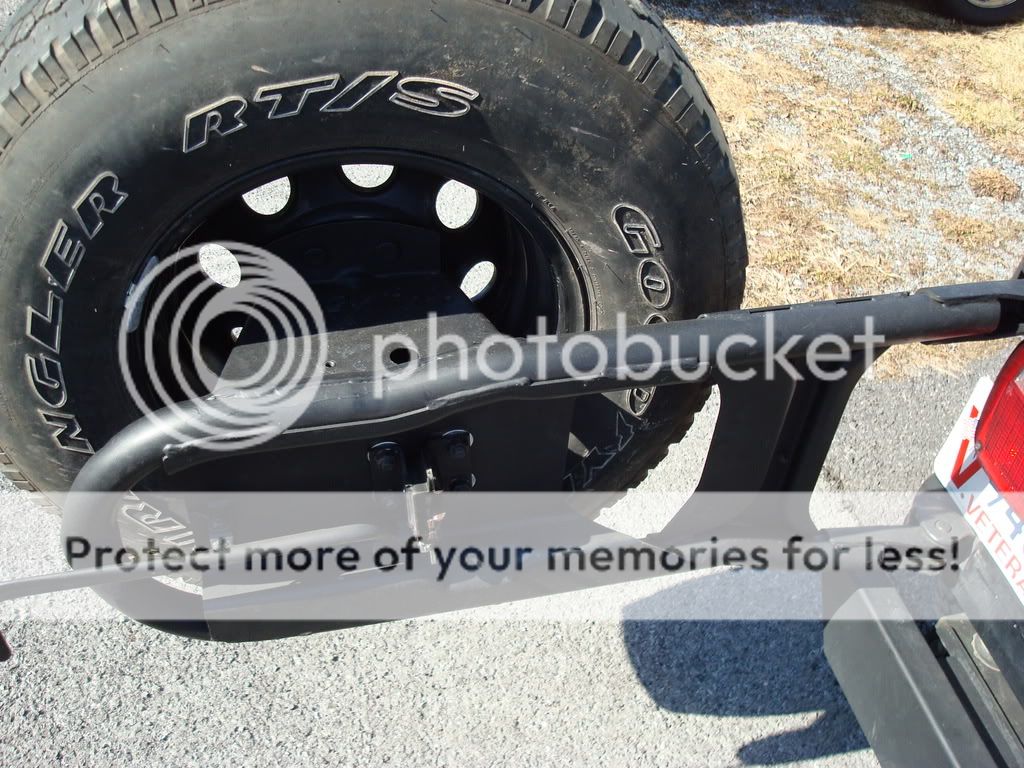

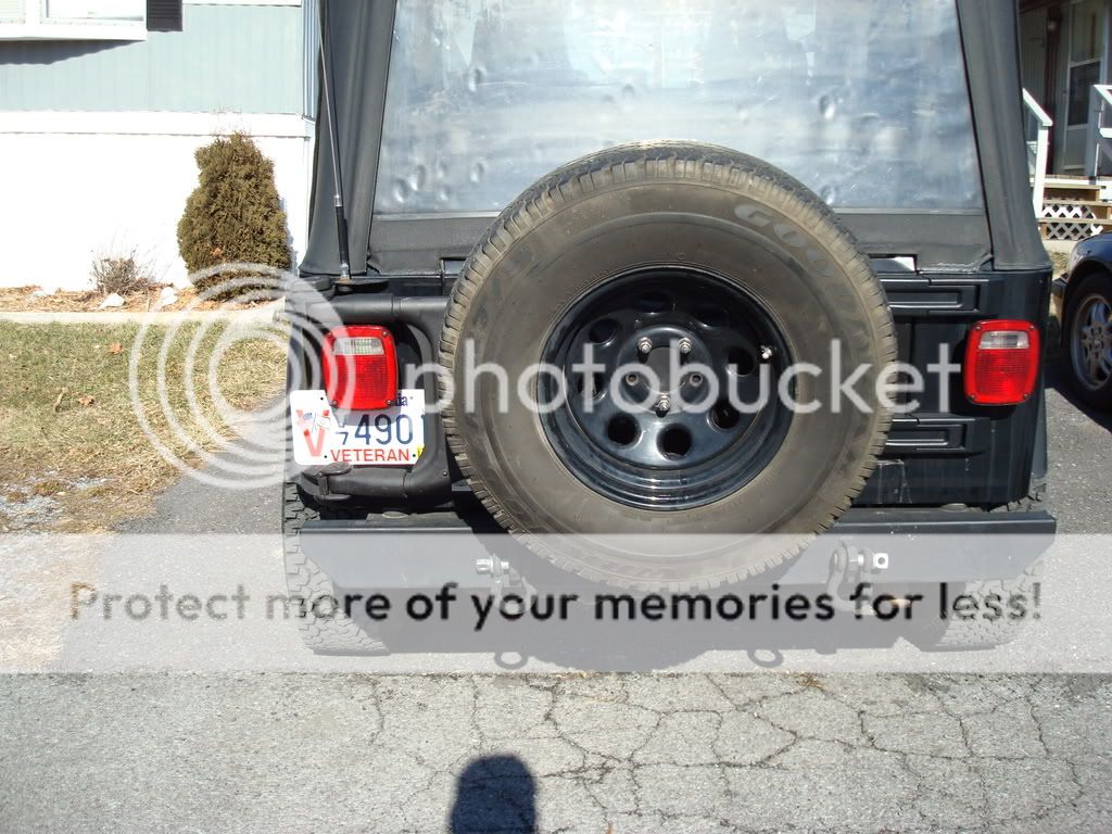

Tire carrier
I modified a Honda passport tire carrier to fit on the jeep.
Not bad for $35
Sorry the pics are so big I'm no techy

did you put plates on the back side for that tire carrier/

Yeah I reinforced the tailgate (original reason for carrier) and put 1/8 inch plate on both sides and ran bolts through for the latch assembly. If it's not stronger it sure is heavier.
edit.... If you're asking about the hinges then yes, I bent 1/8 inch plate to match the contour of the tub and sandwiched the tub between that and the hinges.

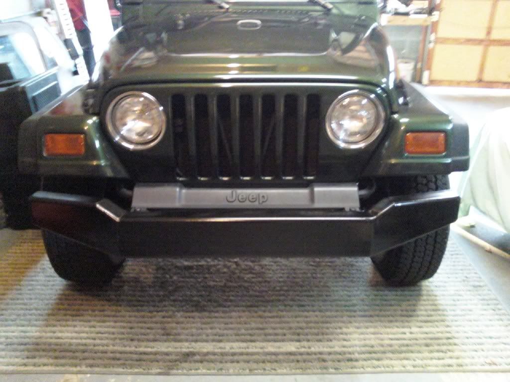

made the bumper this week

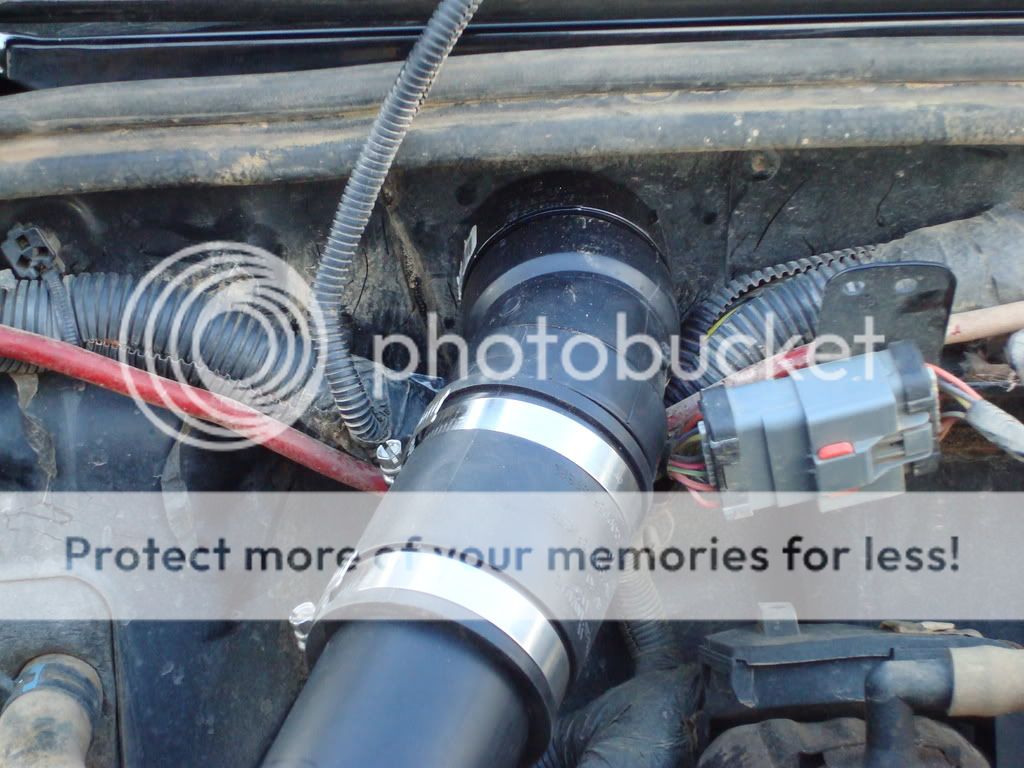

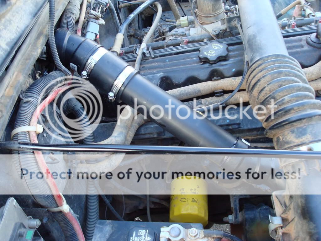

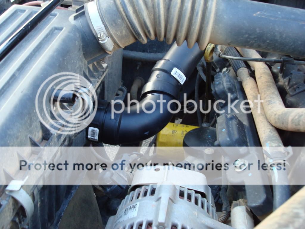

Made a cowl intake
Not a new idea just my version of it.
It works pretty good and I don't have to worry about sucking water again when I enter a water crossing.

Nice work Deet. Sucking water into your engine sucks. Trust me I know from personal experience. What size tube is that?

It's two inch schedule 40. I sealed off the air horn with a cole slaw container lid cut to size and some silicone.
