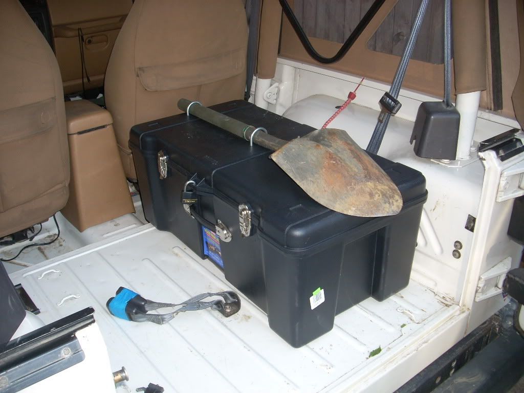

I made myself a custom storage setup.
I took a plastic bin from Wally World and used U-bolts to mount a shovel on the lid:

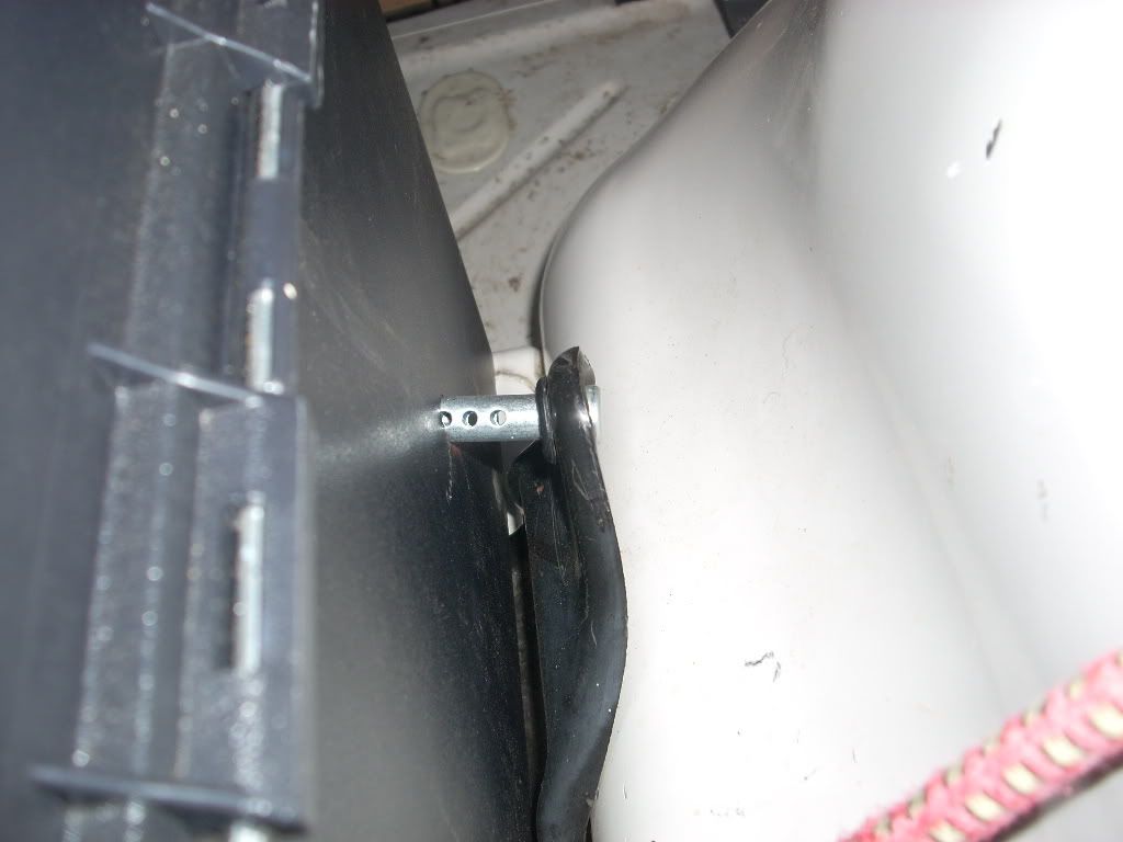

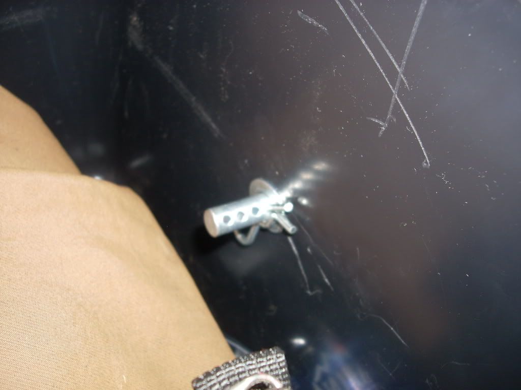

Then, I drilled a hole in the side to put a pin through and hold the box in the Jeep.
I eventually plan to have another box, and I'll figure out how to bolt them together.

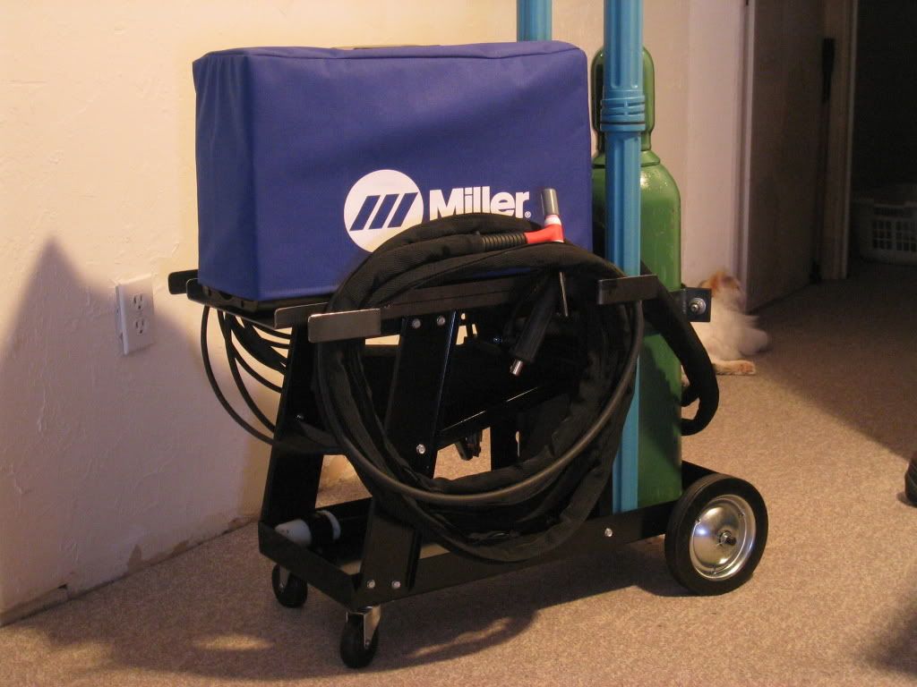

One of the cool thing about tig welders is there also arc welders.
The contractor kit i bought even has a electrode clamp in it.

Nice unit. How much did it cost you?

Here in Canada just before the $ droped it was $2800 for the welder and the blue box with all the goodies
was $700 cdn before tax all in all it was 4 g's but it will last forever.
This is a ac/dc unit so it will weld aluminium as well.
Most people won't need such a over the top item.Mine is a Dynesty 200 DX But a good one for most whold be this one.It is tig and arc but only DC.
http://www.millerwelds.com/products/tig/econotig/
I like mine cus it'll run of 110v,220, three fase with out telling it. I run on 110 for now and have had it up to180a or so.

Thats a nice little set up. Wouldn't mind having one at my house one bit. That way I wouldn't have to mooch off of my job (as much).
